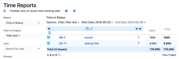

Petter Gonçalves
October 11, 2018
Hello Pedro,
You will have to use a plugin to have the information you are looking for.
My recommendation is the Time Reports for JIRA Cloud which provide you a simple report that displays the time status for the issues you want:
Pedro Román
October 17, 2018
not work correctly, show allways empty results!!!
Petter Gonçalves
October 17, 2018
Hello Pedro,
The plugin is working just fine for me.
What is appearing empty? The filter is not displaying any issues at all or the issues are properly displaying but the column with the statuses are not displaying any values?
If possible, send us a screenshot so we can properly understand what is happening.
