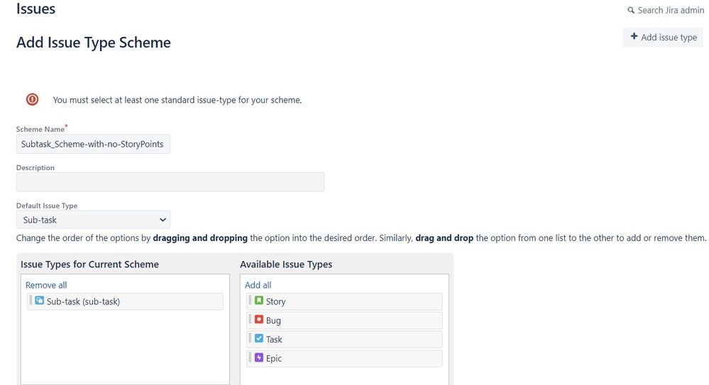

Based on your response does it mean I need to create a new screen for Subtask and configure its filed accordingly. could you help me to know exact steps of doing the same ? because as of now I am facing issues to assign a new screen to subtask. it is saying more than 80 issues will be affected + please create a valid issue type of subtask.

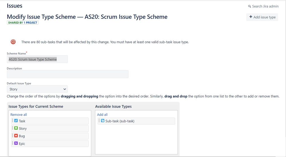

Message appearing when i am trying to remove subtask from the schema used for all issue type is
"There are 80 sub-tasks that will be affected by this change. You must have at least one valid sub-task issue type" .
