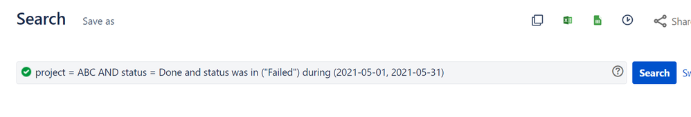

Great - thank you for the updated information. Maybe try a JQL like:
project = ABC AND status = Done and status was in ("Failed") during (2021-05-01, 2021-05-31)
You don't have to include the during and dates at the end. I just thought it would help if you had that requirement.

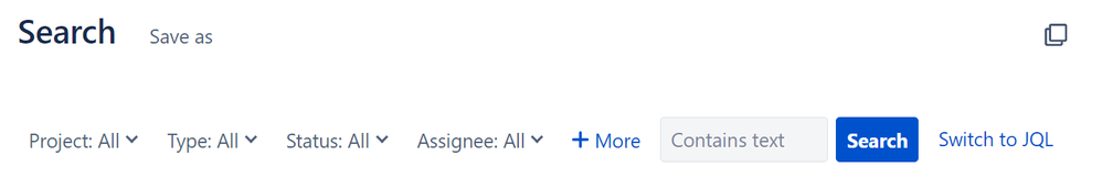

I am a beginner in JIRA, tried some places to input the above query but I could not get to the right place. Would you mind sharing a screenshot?
Thank you.
John Funk
June 3, 2021
Click on the Search box in the top navigation bar
Then click on Advanced Issue Search
Then click on Switch to JQL
Then paste the query above in. Change the project and any date information to be for what you need and click on Search.
