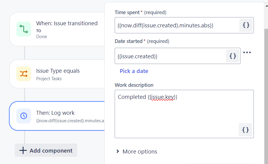

This is my first automation using smart time values; I want to create an automation to calculate time logged as the difference between when the issue is created and when it is closed. Background - these are typically 5-10 minutes tasks. So, the trigger is when the issue is transitioned to Done:
Date started: {{issue.created}}
Time spent: {{now.diff(issue.created).minutes}}
Work description: Completed {{issue.key}}
Wheat am I doing wrong here? Thanks.

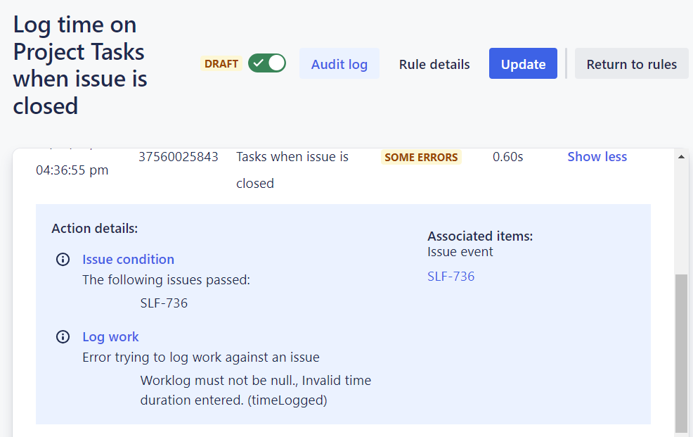

2. The details from the rule execution log
3. A description in your words of how the results don't match your expectations.
Is the information you provide the entries for a Log Work action?
Do you get a new worklog entry on the issue? If you do, what value is being shown for time spent?

The result I am seeking is a time entry for work performed on the issue that is equal to the difference between when the issue was created and when it was closed: issues are reported be end users in Teams, whereupon the support team creates the Jira ticket using the Teams-Jira integration, actions the request, and closes the Jira ticket, all in Teams. Yes, the goal is to move the requests to Jira Service Management but the organization is not ready for that yet.
