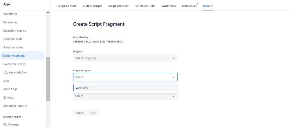

After installing Script Runner for Cloud, I am using Script Fragments to create a button. While creating script fragments, I am not getting any options except Web Panel. How can I achieve this functionality?Screenshot 2023-11-21 102557.png

In that demo they show selecting WebPanel for the Fragment type, so I don't think that there is a Fragment Type specifically for Button.
However, as the demo proceeds they do show that what was created does produce a button.

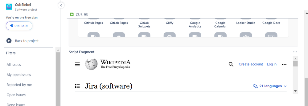

In Jira Cloud, using Script Fragments, I can display an external page, similar to displaying a wiki page in the screenshot.
However, I am unable to create a button as demonstrated in the video or in documentation.

Hi Ankush,
ScriptRunner for Jira cloud can display custom HTML, CSS and Javascript, which means you could write some custom HTML hosted somewhere externally, such as CodePen as mentioned in the documentation here.
This custom HTML CSS and Javascript would define the logic to create the button that you require and you would then reference this in the fragment to have the button displayed on the issue.
If you need to communicate with Jira to get data out, you must use the Adaptavist Bridge, as documented here
If you need further assistance, I would advise raising a support request here.

Speaking to your response that you don't see the same options in your Jira Cloud instance that you see in the demo video and the documents you referenced, be advised that both of those are references for self-hosted Jira (Jira Server or Jira Data Center), not Jira Cloud. The options in Jira Cloud are different.
You can tell that the demo video is not for Jira Cloud by looking at the URL shown in the browser window in the video. It shows "https://localhost:8080". If it was a Jira Cloud instance it would show a URL like "https://someCompany.atlassian.net". All Jira Cloud instances have a URL in the atlassian.net domain.
