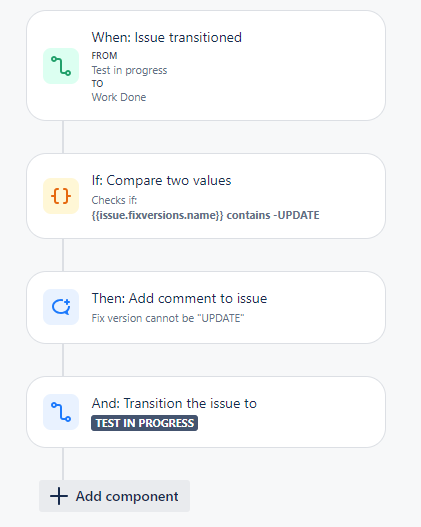

Thanks for your reply.
Comparison worked and I am able to add a comment.
But issue is that it is transitioned to the next state. I want to block it and keep it in the previous status only.
in the below example it should be in Test in progress. But it is in workdone after i run this rule
In Jira Automation, there isn't a direct way to "block" a transition during the event itself, but you can simulate this by immediately transitioning the issue back to its previous status if it contains "-UPDATE" in the fixVersion. Here is how you can set up the rule:
