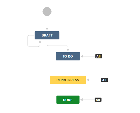

Step 1) Create a ghost status in your workflow. This status is one every subtask will pass through when created, but will automatically pass on to whatever your current first status is untouched unless other post-function is fired when doing the JMWE issue create. For the sake of this description I'll call it 'Draft'.
Step 2) Have a transition going from your 'To Do' status from your ghost status and call it 'Advance'.
Step 3) Create a loop-back transition on your ghost status and call it 'Assign-Loop'. Create a post-function on that transition in JMWE for 'Assign to role member (JMWE add-on)' and enter 'Project Leads' role (insert your desired role in place of 'Project Leads' here).

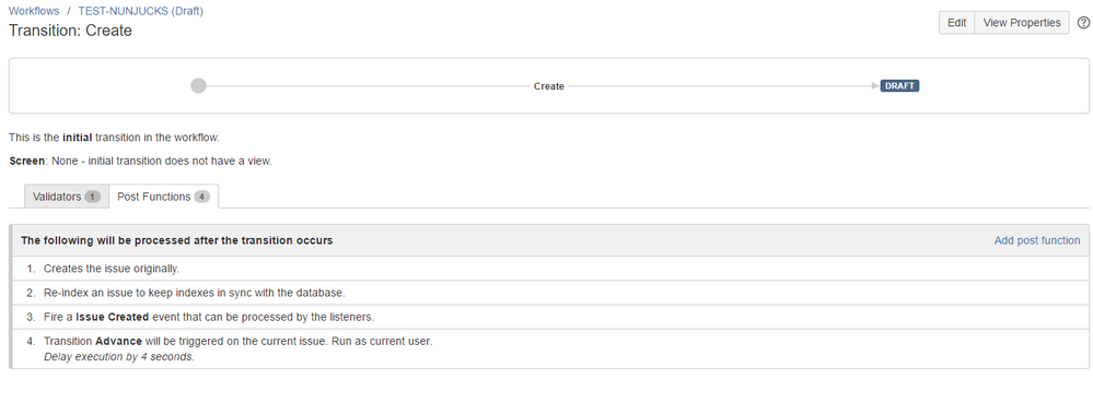

Step 4) In the diagram view of your workflow, click the transition line before your ghost status which is your 'create' transition. Open the post-functions and choose 'Transition Current Issue'. Use the 'Advance' transition you created in step 2, choose to delay the execution by 4 seconds, and (IMPORTANT) move that transition all the way to the bottom of the list of post-functions for that transition.

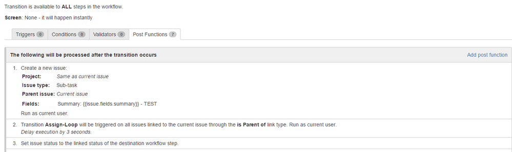

Step 5) Go to your original JMWE Post-Function where you call to create the subtask. For testing and example I did it on the 'In Progress' transition for this explanation. Here directly under your 'Create a new issue' JMWE you are going to add another post-function to 'Transition a linked issue'. Set it to link type 'is Parent of', and to run the transition 'Assign-Loop' that you created in Step 3 (above). Finally, delay this execution by 3 seconds.
