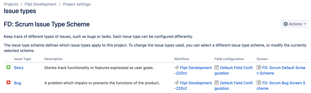

Thomas Fritzen
August 19, 2020
I am bullet point
Locate the field in the Issue Layout and click on it
I see this.  what do I select from here.
Thomas

Hi @Thomas Fritzen
You're in a Classic Project - the question is posted in the Next-Gen area which is why I assumed you might be in that project type.
For Classic Projects, you'll need to be a Jira Admin to make the modification - then:
  1. Go to Jira Settings (cog icon in top-right) > Issues
  2. Select Custom Fields from the left-hand menu
  3. Search for your field - then select the breadcrumbs (3-dots icon) on the far-right of the field's row
  4. From the menu, select "Contexts and Default Value"
  5. Select "Edit Options" - fill in new options and press "Add"
  6. Select "Done" when complete
^ Just remember that this will change the options for all screens that use this field - and all projects using the same screens in their screen schemes / issue type screen scheme.
If you do have multiple projects utilising the fields and you want to change the options for just a selection of them:
  1. From Step 4 above, press "Add new context" first
  2. Give the scheme a name, confirm which issue types the options will apply to - and select just the required projects from the list - then press "Add"
  3. Your new scheme will appear below the original - from here, you can configure options which will only appear in your project and the issue types you select - all other projects / issue types will use the Default
Let us know if you need any further help :)
