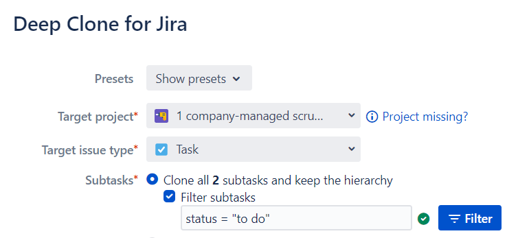

If you need to perform similar actions on a regular basis I can also recommend Deep Clone for Jira.
With our app it is possible to bulk clone tasks along with subtasks and filter the subtasks using JQL as you can see in the screenshot below.
