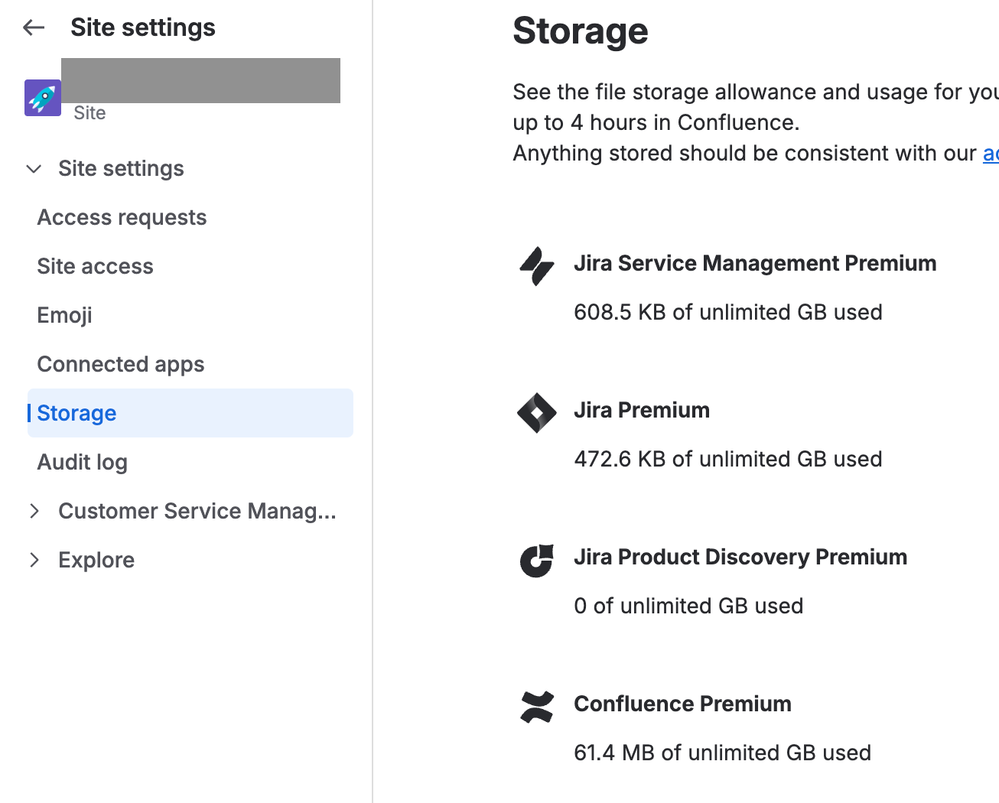

If the product is truly on the Premium plan can view the amount of storage used following the guidance in the document link I provided in my response. This information will be accessible to Organization Admins, Site Admins, and Product Admins. It is true that remaining space will not be shown for products under a Premium plan as in that plan the storage is unlimited. Here is an example of what can be seen for a site where Jira, JSM, JPD, and Confluence are all using Premium subscriptions.
