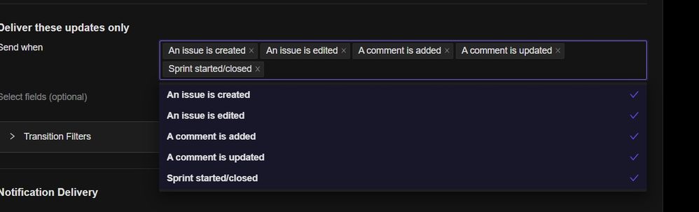

Once 100 Jira tickets is created in the event filter you can remove the "an issue is created" event from list and save it. Do the same for creation event. then you will not receive notifications.
Let me know if it works

Would this solution apply across all Issue Types within a Project? I would like to isolate this to just one Issue Type ideally.
