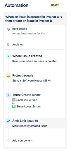

To properly create a linked issue via automation, you can use a rule like this (sample from the template library):
To sync the status between issues, you can set up a global automation rule that does the following:
Trigger: issue transitioned
Condition: project = "Project A"
Branch: linked issues -> Action: transition issue
