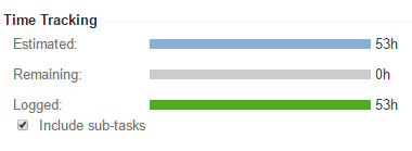

I'm not sure that you need a custom field to capture this information. In the Time Tracking section on an issue with sub-tasks, there should be a checkbox that says, "Include sub-tasks."
The "Logged" bar shows all worklogs for the parent issue and its subtasks. You can also view this information in the Issue Navigator using the Σ Time Spent column.

We used this solution when we used Jira Server, but we migrated to Jira Cloud and there I can't find the checkbox.
The Σ Time Spent field only shows all time I logged on this issue, not the time my teammates logged.
Frank Schalkwijk
May 1, 2017
Thank you for your response you pointed me in the right direction. The Tempo Timesheets plugin removes this checkbox and breaks the Σ Time Spent field. I wil report a bug with them to get this fixed.
