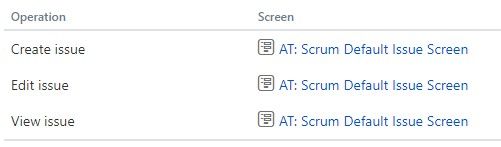

I confirm removing the Resolution field from the screen (in the case of my project this was not the "create issue" but the "Scrum default issue" and "Bug default issue" screens) solved the problem. I tried editing the "Create" transition so that it cleared the resolution field at the moment of creating an item but that did not work. I just did that to try, I know it's not the right thing to do.
Nic Brough -Adaptavist-
October 29, 2021
It was the create screen.
Screens can be called anything, it doesn't matter if it was called "scrum default", "bug default issue", or even "not the create screen".  The create screen is the screen the project and issue type have been told to use when someone clicks "create issue".  It's defined by the issue type screen scheme.
Allan Hernandez
October 29, 2021
Hi Nic
According to the new Jira issue view, Create issue is the operation not the name of the screen. In turn, it brings the Scrum Default Issue screen.
Regardless, I just arrived here from google search and found your answer helpful. Thanks.

There are no "templates", and the project setup never adds resolution to any screen.  So one of your admins added it at some point!

Whoever setup the screens put it on the screen used for create. JIRA allows a create, edit, and view screen. If they aren't defined the default screen is used. So if you don't have a specific create screen for the issue/project it will use the default screen. It isn't a bug, just the way the application is designed.
