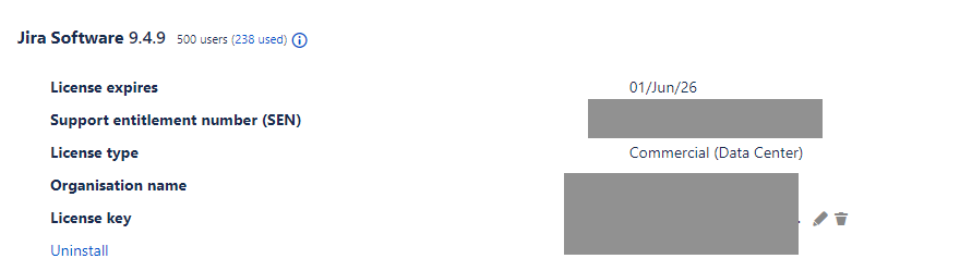

First, to find out the license type you have and if/when it expired navigate to
- the gear icon near your avatar in the upper right corner
- select Applications
That will show you something like this that includes the expiration date and license type.
Since you say your Jira instance is still functional, it is a Server license. Data Center licenses cause the system to go into a read-only state when the license expires.
