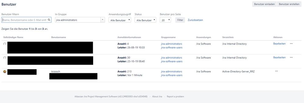

Deleted user
December 11, 2019
I'm already in the group of the jira administrators, But I can't see the entry "Validators()".

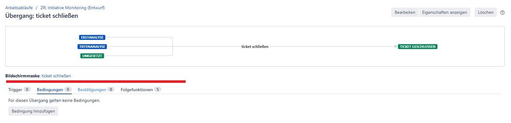

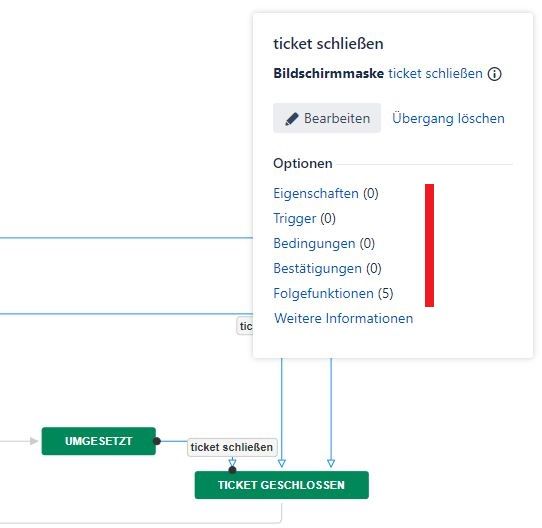

Deleted user
December 11, 2019
Here are two screenshots. (from the transition "ticket schließen") The red line marks the place where i expect the entry validators.
Deleted user
December 12, 2019
I think the term validator is corresponding to "Bestätigungen" in german. So in this case the issue is solved.
Luke
December 12, 2019
Can confirm, validators is translated to "Bestätigungen" if you've got it set to German.
Had to get used to it as well when switching from an English instance to a German one.
