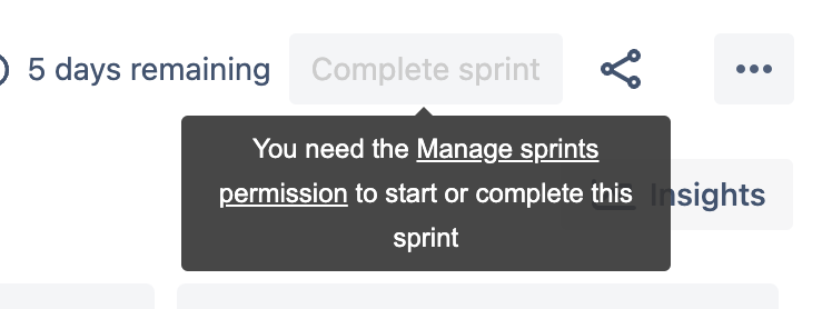

I have all of the roles which are required for managing a backlog but the *Complete Sprint* button is not showing up.Screen Shot 2023-04-18 at 5.16.23 PM.png

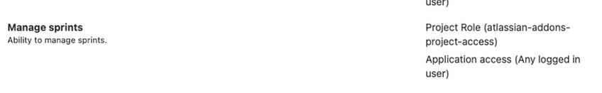

The next step is to review the Permission Scheme associated with the project and ensure you have the Manage Sprint permission.
Are you a member of a group or role that has been granted that permission?
Are you able to Create and Start sprints on the board?
If you hover your mouse over the "Complete Sprint" button do any messages display?

Yes, I do have permission to be a Sprint Manager, and able to create a new sprint but unfortunately still not been able to complete a sprint. I am not sure why, looks like i have granted with all necessary roles.
Ekaterina Berestovenko
April 19, 2023
That's what it's showing me, and I do have this permission Screen Shot 2023-04-19 at 2.15.41 PM.png
