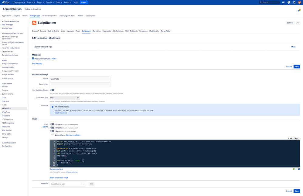

Below is a working sample Server-Side Behaviour code for your reference:-
import com.onresolve.jira.groovy.user.FieldBehaviours
import groovy.transform.BaseScript
@BaseScript FieldBehaviours behaviours
def list1 = getFieldById(fieldChanged)
def list1Value = list1.value.toString()
showTab(1)
if(list1Value == 'Hide') {
hideTab(1)
Please note, this sample code is not 100% exact to your environment. Hence, you will need to make the required modifications.
What this code does is that when the Hide option is selected from the list, the second tab, i.e. Tab 2, will be hidden. Else, if any other option is selected, the second tab is made visible once again.

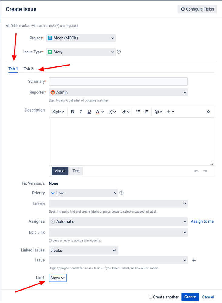

Below is a print screen of the Behaviour configuration for your reference:-

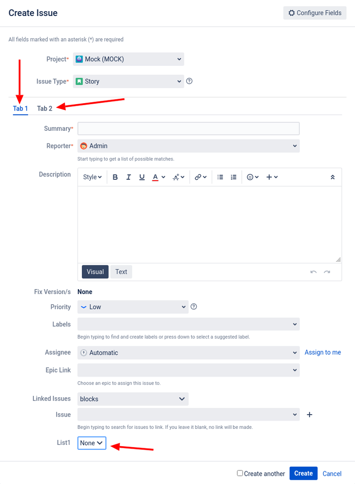

Also, I am including a few test screens for your reference:-
If the option selected from the List 1 field is either None or Show, both the tabs will be visible as shown in the first two print screens below:-

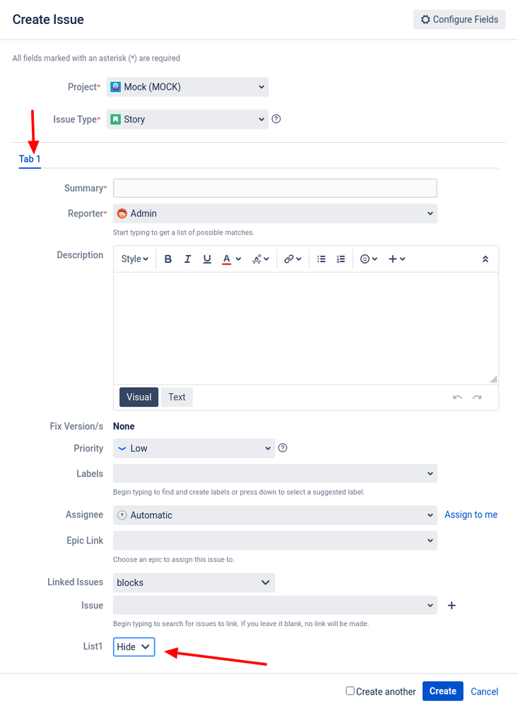

If the option selected from List 1 is Hide, the second tab will be hidden as shown in the image below:-
