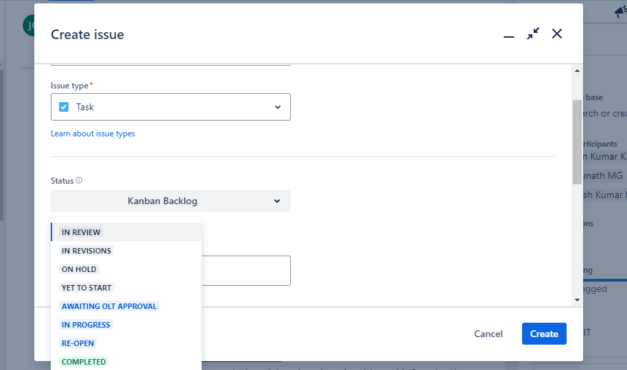

1)When we create a ticket, it should be categorized under the "YET TO START" bucket immediately. However, the system defaults it to the Backlog status instead.

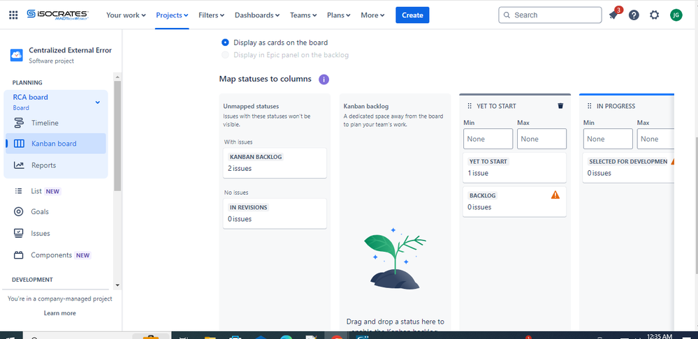

Go to board , Configure board (three dots on right top)
Select columns
Check : Map statuses to columns
1. "Completed" status should have been mapped to "Done" column(or "Completed" column).

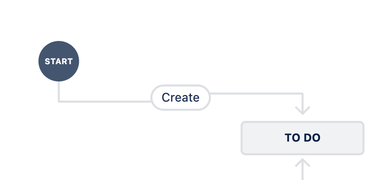

1. By default when you create an issue it will be set to the status that is indicated by the arrow that goes from the gray circle to a Status value, in the Workflow for that type of issue. Example:

Issues will show in the board columns based on the status the issue is assigned, and based on how the available Status values are mapped to the board Columns. If you click on the ... button above the board on the right and select Configure Board you should either immediately see a screen showing the Statuses and Columns, or you'll see options on the left where you can select Columns. Please display the Columns information and share a screen image of that with us.

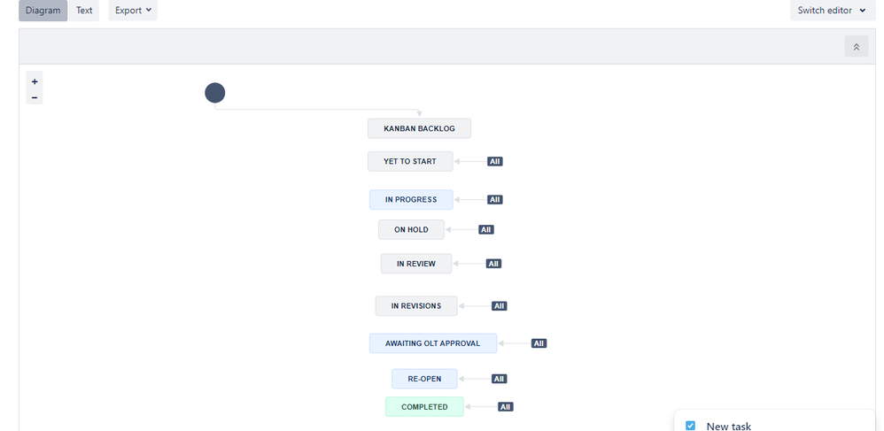

Jeevan Kumar K G
April 29, 2024
Jeevan Kumar K G
April 29, 2024
Hello Truday,
Thanks for your response and i have shared the workflow diagram for your reference.

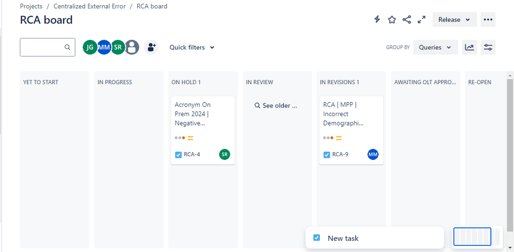

Jeevan Kumar K G
April 29, 2024
Deleted user
April 29, 2024
Kanban backlog(2 issues) is unmapped, you may move this to "yet to start" if you wish to appear them on board or map it to "Kanban Backlog" column if you wish to appear them in backlog.

Trudy P Claspill
April 29, 2024
Hello @Jeevan Kumar K G

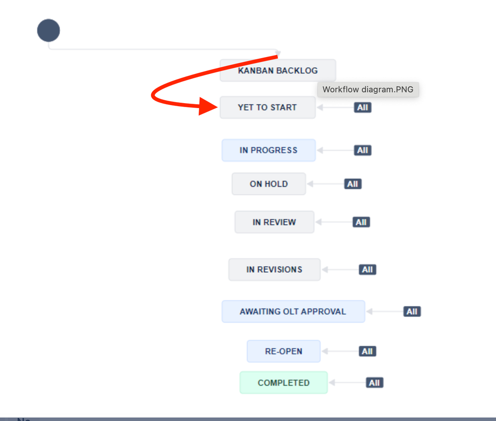

If you want your issues to default to the status "Yet to Start", then in the Workflow diagram grab the end of the arrow from the gray circle going to "Kanban Backlog" and drag it to the "Yet to Start" status.
If you want to keep the Kanban Backlog status available in your workflow, you will need to add a Transition to it.
Regarding the issues moved to the Completed status not showing up in the "Completed" bucket on the board, we will need to see the portion of the Columns page that shows the Completed column. Is the "Completed" status mapped to that column?
If it is and the issue are still not showing up, then you should check the filter and subfilter for the board to see if they include criteria that would exclude those issues from displaying on the board.
