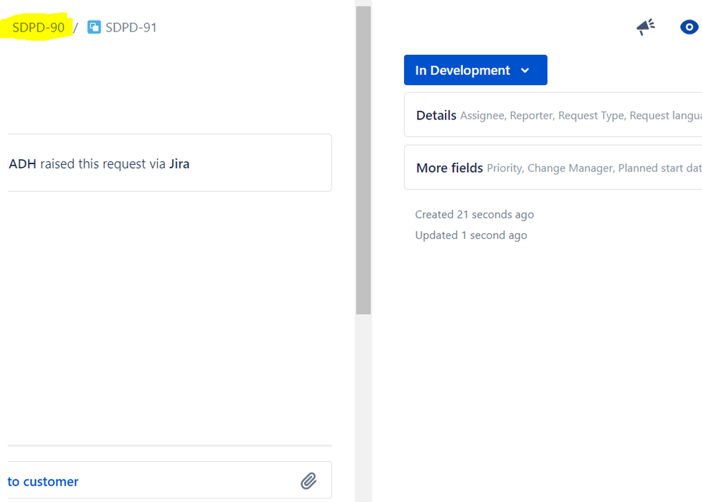

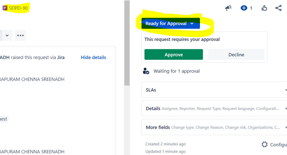

Once i create the change request in that i have created a Subtask as well.
If i change the Subtask status from Ready for Approval to In Development
then Parent change Request Status also modify to In Development

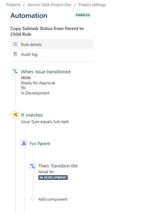

Thanks for your response.!
I have update as per your justification but it is not working as expected.
Please find the attached screenshots .

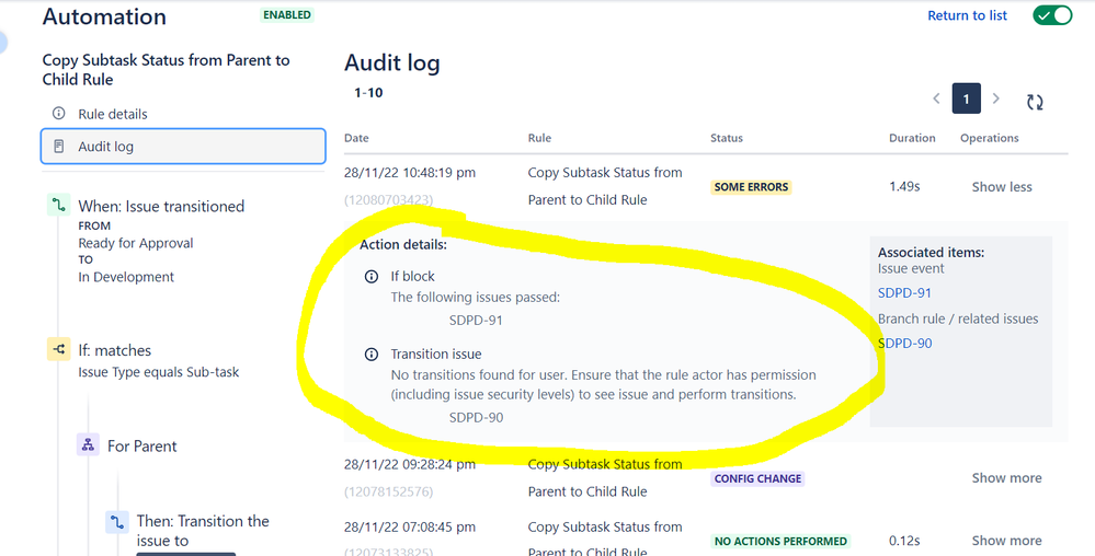

@Sreenadh can you please post a screenshot of the automation audit log as it allows us to review execution data for the rule such as when the rule was triggered, the final result of the execution, and any actions/error details.
It looks something like this:
Sure here it is.
Thanks for providing those screenshots, they were helpful.
So there's an approval step in the workflow, where someone needs to approve the issue in order for it to transition from Ready for Approval to In Development — can you confirm if this is the case?
No transitions found for user. Ensure that the rule actor has permission (including issue security levels) to see issue and perform transitions
If that is the case, then it's likely that the rule actor which is Automation for Jira does not have permission to approve and therefore transition the (parent) issue to In Development.
Another possible reason for this rule failing is when there is a missing transition from the target issue workflow, going from the current status (ready for approval) to the new status (in development) in your parent issue's associated workflow — however, this does not seem to be the case.
Yes Exactly correct, Change Request Approver need to approve the request then it will move to In Development.

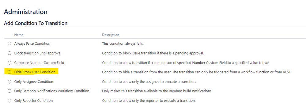

One workaround could be that you update your project's workflow associated to the parent issue. You could create another transition (similar to the approve transition) that goes from Ready for Approval to In Development but do not add an approval step to this workflow transition. This should allow Automation for Jira to take this path and update the status as per the automation rule.
| Tip: As an added measure, you could also add a Hide From User Condition to this new workflow transition. What this condition does is that it hides this transition from the user (humans) so that they won't be able to select and bypass the approval step. However, it remains available to Jira Automation, scripts, remote API calls, post-functions, etc. |
