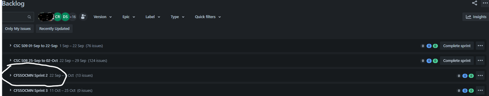

Hi @Suresh Nagappan , can you share a screenshot of your backlog? Also is there currently an active sprint?
Thanks for responding.

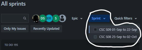

Please find the screen shot above, the "Backlog" tab from Scrum Board showing all the Sprints that were created, the first 2 are "Active Sprints" and the Circled one is "Future Sprints". The 2nd screen shot showing "All sprints" tab where the Sprint Filter only showing the 1st 2 "Active Sprints" but missing the circled "Future Sprint". This is a new Project and new Scrum Board, so not sure which settings need to be changed. The final screenshot showing that "Manage Sprints" under Permission tab in Settings clearly showing that Admin role has access and I am an Admin to this Project.
My ask is why is my Sprint ("CFSSOCMN Sprint2") not showing in the Sprint Filter?
How can I make my Sprint ("CFSSOCMN Sprint2") Active, so it shows up in the Filter?

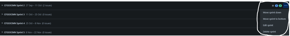

From the Backlog, if you click on the ellipses to the right of the inactive sprint what are your options?

The below screen shot showing "Sprint Start" button active for another project. I need this "Sprint Start" button to be active for this new Project. If someone can help me how to enable this, I should be all set.

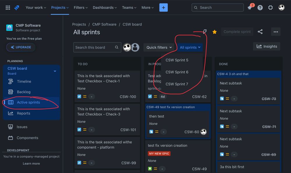

Thanks for clarifying. I'm not immediately seeing the problem here obviously. As an example here's what I see when running parallel sprints as it administrator. As you can see, I have three active sprints, and in the backlog I have one inactive sprint that presents the start sprint button. It might require you reaching out to Atlassian support. It appears that you are on the premium platform which should result in a quick turnaround. If you do reach out to them, please update this post with the final results.
