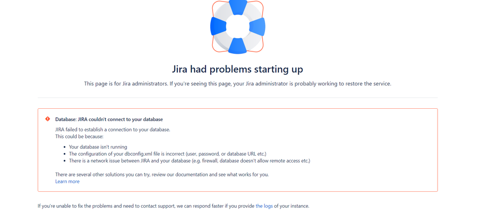

I have jira 7.8.0 in my system. After upgrade to 9.1.0. Database not connected and unfortunately I forget the user id and password. How do I recover. Please help

Yes I have used same dbconfig.xml from backup in updated version but same error is showing.

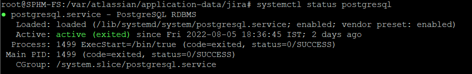

Did you checked weather your database is running or not may be that could be the reason to get this error.
Your database is in the same sever or different server.
You can check with
systemctl status postgresql
or
status postgresql-9.6 status
where postgresql-9.6 you can replace with your database version.
