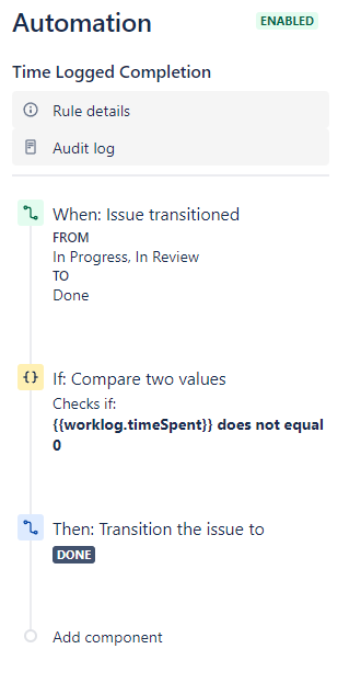

It looks like you're not able to add a validator when your project is Team-based and I don't think I'll get the budget to get a script runner. Any other options?
Here is what I have tried... there doesn't seem to be a way to check if the syntax is correct.
