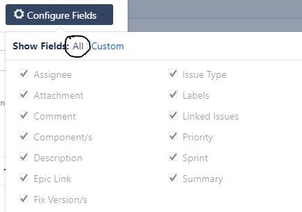

If this is what you are referring to, it is on "All".

Hey Matthew,
I'm referring to Screen Schemes.  If you are not an admin on the project you wouldn't have access to them.  There is a way to add fields to that list: https://confluence.atlassian.com/adminjiraserver/defining-a-screen-938847288.html
You (or a project admin) should just need to add the "Time Tracking" fields to your scheme and you should be able to add estiamtes.

Thanks for the help. Adding them to the screens now with an admin.
