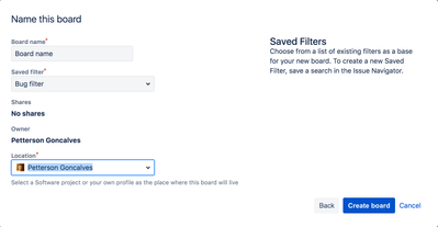

I believe there are two options that you can choose to achieve your target:
1 - You can configure a board to return issues from a Service Desk project
- Navigate to Search > Search all issues
- Configure a filter to return all your Service Desk issues
- Click in the search button > Click on Boards:
- Click to create a Kanban Board > Click to create a board from the existing filter you created
- Select the location where the board will be placed - It can be any software project or your own profile

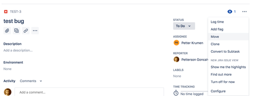

2 - You can move your issues from the Service Desk project to a software project
- Create a board like above, but creating a software project for it
- Navigate to your Service Desk issues > Click on the three dots > Click to move it to the software project
Let me know if one of the options above helps you.
