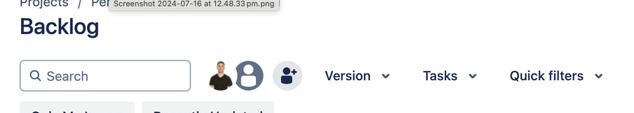

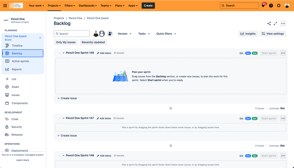

I closed my sprint and now I cannot see any task in backlog to start a new sprint
Greg Armstrong
July 16, 2024
Hi there,
I use Jira Cloud and closed the active sprint. When I went to the Backlog to adjust the tasks in the backlog I cannot see any tasks an there is only one user (me) in the backlog.
We all our developers log in they only see their user in the backlog and also no tasks at all.
We desperately need to get this working again as we manage all our product development and support through this Jira project board and now we have to manually figure out what to work on next and what status each task it at.
Any help greatly appreciated.

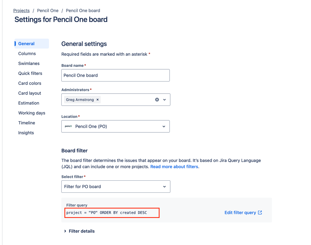

July 16, 2024
Hello @Greg Armstrong

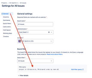

What is the filter used by that board? To find that click on the ... button in the upper right corner above the View settings button and select Configure board
Select the General tab and tell us what it says in the filter query area.
It is possible that the query has been changed such that the issues are all being hidden from view.

Hi @Trudy P Claspill ,
Thanks for following up.
The settings are as per the attached screenshot.
Should I update "project = "PO" ORDER BY created "DESC" to project = (PO) ORDER BY created DESC"?

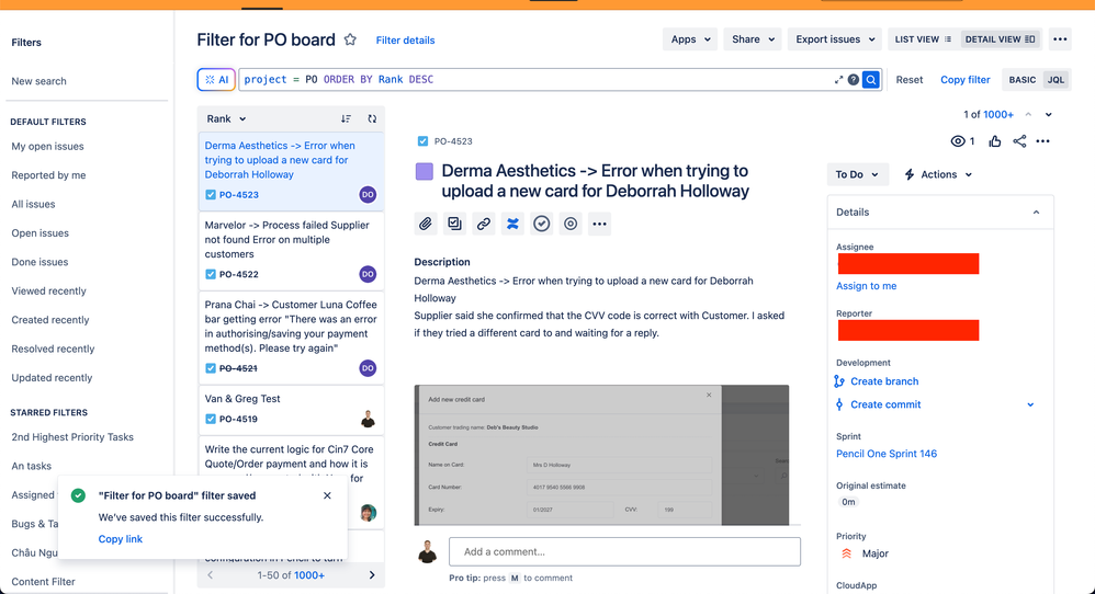

We tried changing the filter to the following:
project = "PO" ORDER BY created DESC
project = "PO" ORDER BY created aSC
project = "Pencil One" order by rank aSC
project = "PO" order by rank aSC
project = PO ORDER BY Rank DESC
All return results except for the one (PO). Screenshot 2024-07-17 at 3.54.34 pm.png
Could this be a reindexing issue that we cannot resolve ourselves?
This issue is killing us as we mange projects from 4 different countries/locations and now we have no easy way to know where all our tasks are at.
Any help in solving this is greatly appreciated.
Thanks,
Greg

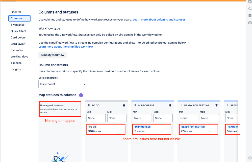

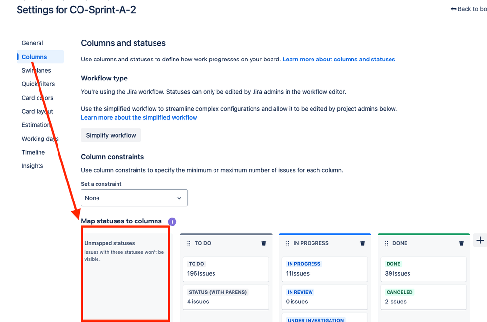

Please check the Columns/Status mapping configuration for the board and make sure that all statuses are mapped to columns and none of the statuses are in the Unmapped Statuses area. Issues in the statuses that are in the Unmapped Statuses area will not be visible in the board or backlog.

Greg Armstrong
July 17, 2024
I am the Jira admin, I will figure out how to contact them to see if they can reindex for me.
Regarding the columns, we have used this board for 6 and half years now and mapped all the columns then. I've attached a screenshot of the view. Interestingly it shows there are Jira issues in each column, just not visible in the Backlog.
Any other suggestions?🙏

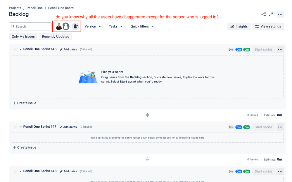

Greg Armstrong
July 17, 2024
A couple of other things.
The first is all the users except for the person who is logged in have disappeared from the backlog. See attached screenshot for reference.
Secondly, when I view our Products, there is "Jira Product Discovery" with one user (me). Could this be causing the issue?
Thanks,
Greg

The Assignee avatars should display the logged in user and avatars for any user that is assigned to a visible issue.
Can you pull down each of the filtering buttons at the top of the screen and confirm that no filters are selected?
I ask because where yours says "Tasks" mine says "Type". I'm curious if you are filtering by the Task issue type, and/or what options are available for that pull-down.
