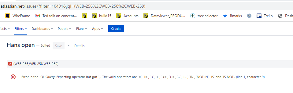

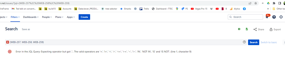

If I enter
(WEB-257,WEB-258,WEB-259)
then I get an error (as per the image)
No I'm not able to find the issues.
It shouldn't be (WEB-257,WEB-258,WEB-259) but rather key in (WEB-257,WEB-258,WEB-259)

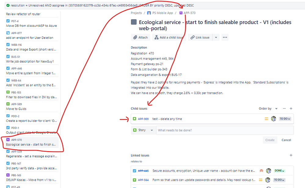

I can create children in Epics - see image.
Thank you.
Creating a child issue in an Epic ("parent/child relationship" from Epic to Standard Issue Type) is different from creating a Subtask ("parent/child relationship" from Standard Issue Type to Subtask Issue Type).
Nevertheless the Child issues created in your Epic should not have disappeared.
This is not the same as a Linked issue ("horizontal" relationship) between standard issues types.
