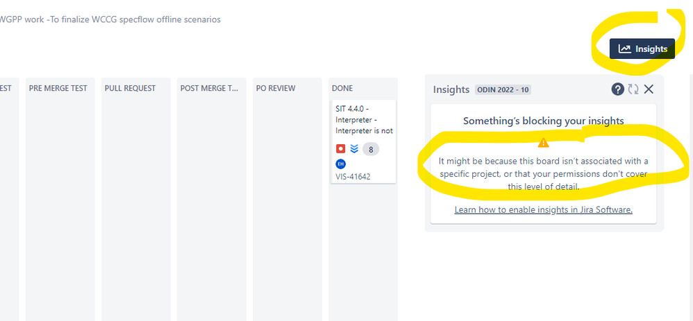

I cannot view "the insights of the active sprint"
Ahmed Maher
May 25, 2022
I cannot view "the insights of the active sprint" although the permission is granted to me and the board is associated with a specific project. What shall I do to fix this issue?
Andy Heinzer
May 27, 2022
Hi Ahmed,
I can see that you have some project permissions, at least enough to view issues in the VIS project.  But board filters can be complex in a way to pull issues from other projects.  Could you share with us the JQL for that board filter?  If you're unfamiliar with this part please see Editing a boards filter for info.
If you don't have the project permissions in all the projects where that filter can select issues from, then that would explain this behavior.
Andy
Ahmed Maher
May 29, 2022
Yes, that was the issue. I have just updated the JQL Filter and it works now ...
Many thanks to you, Andy!
