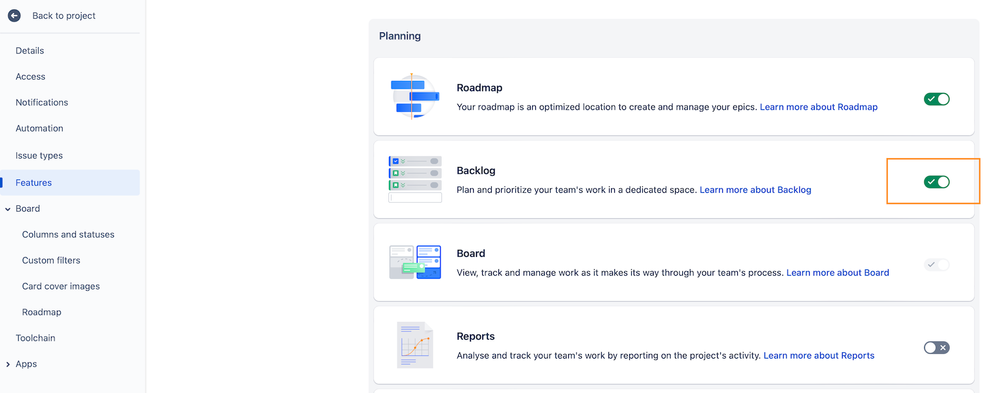

In your board, select `Project settings` in the left panel.
You can find the `Backlog` option in the `Features` section.
Joe Hodgetts
March 14, 2024
This should be the top answer.

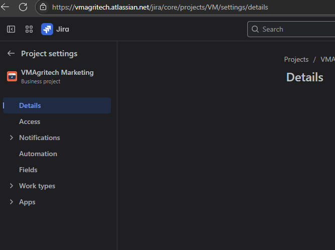

Jodi Creasap Gee
May 14, 2025
I don't have this Features option in my Project settings:
How do I add the backlog in this project?
Rich Gonyea
May 14, 2025
Your Type of project is "Business project", that might limit what features you get.
In a "Software project" type project, there is a Features tab that allows for turning on the Backlog view.  Under the Details tab, I see the project type field, but I am not allowed to change it.  You may want to search the forums for "Jira Business project backlog" or "Change my Jira Project Type".

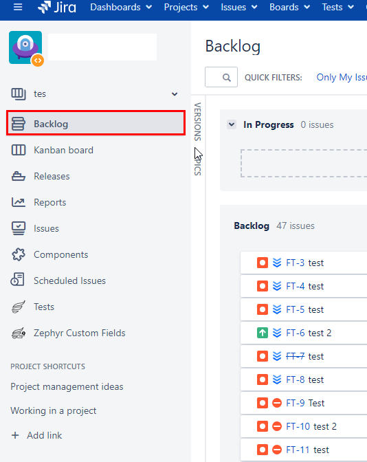

In jira server, when you go to your project it appears on the left panel
If you can't see the backlog option, make sure that you created a board before. Make sure that you have created a software project.

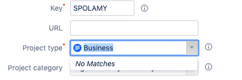

artmy_mx
August 9, 2019
OK but when I create a new project, the only available option is Business.

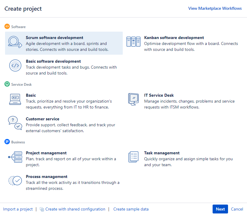

I'm not sure but this screen, seem to be the change detail project screen. Make sure you have admin right on yout jira instance. Or ask your administrator to change the project type or create o new one.
When you create a new project you have this page 2019-08-09 11_02_36-Window.png

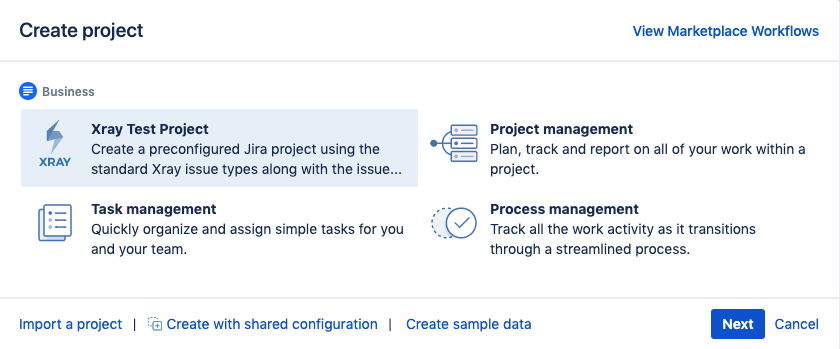

artmy_mx
August 9, 2019
OK, I am as Administrator and when I try to create a New Project, my view is this one:
