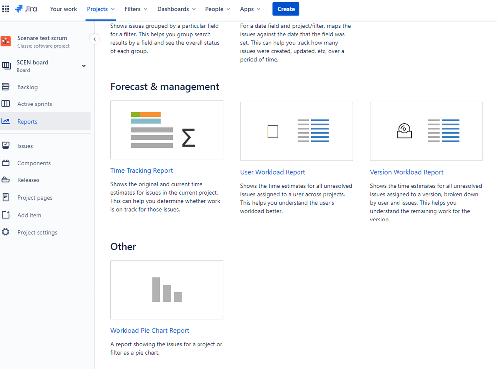

Hello @Alison O_Brien ,
the article you refer to is for Server/ Data Center 6.4. The report is also available in Cloud though - just navigate to the left panel of your project and scroll down to Time Tracking report, see the screen:
screenshot.PNGIt seems this report is not available in next gen projects though, just classic.

Alison O_Brien
January 5, 2021
Do you know if there is a workaround?  Can you change project types after creating tasks and tracking time?

Adam Rypel _MoroSystems_
January 5, 2021
I suppose you are on next gen project then. You could either use some third party app as you mentioned - not really sure exactly which one works the best in next gen projects, you would have to try them out.
Or you can migrate to classic project - unfortunately it is not possible to just change project types - as mentioned by Trudy above. See how to migrate the tasks here: https://support.atlassian.com/jira-software-cloud/docs/migrate-between-next-gen-and-classic-projects/
The logged time should remain in the tasks. But please test all the scenarios first, I do not want you to lose any data! :)
