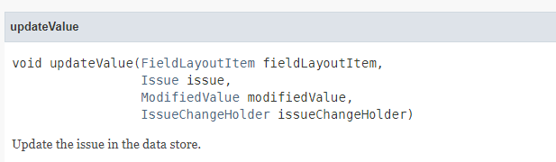

jack ma
August 8, 2021
Hi @Martin Bayer _MoroSystems_ s_r_o__ @Vikrant Yadav  I really appreciate your help very much. I have found a way to update the value of the parent task field, Use the following method can meet my needs.
customField.updateValue(fieldLayoutItem,mutableIssue,modifiedValue,issueChangeHolder);
Like # people like this
