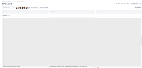

Can you provide a screen image of your board and a screen image of the details of one of the issues that is displayed that you think should not be?

Thank you for responding @Trudy P Claspill ! I was going to get that for you but now when I go to the project, I can't even find the boards. I am presented with this message (image 1).
What I don't understand is that the individuals who I made the board for have confirmed it does exist. They even see 2 because I created another one this morning because I thought the original was deleted (when in reality I just can't see it). Here's the proof it exists. (image 2)

@Trudy P Claspill  I got it figured out. Somehow the board settings got switched to private and only one individual had access. I have no idea how that happened because I set it to be public. :shrug

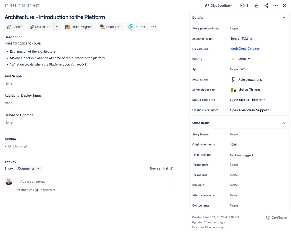

Here are screen images:
I'm guessing it has something to do with the resolution......but I always thought if you moved something to Done, it resolved it as well, looks like that's not the case.

1. Normally the Status and Resolution (if set) will display in the upper right above the Details panel, but I don't see that in your issue details screen. Is that info really missing from the screen, or have you scrolled and it is simply not in the image you provided.

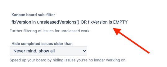

3. Do you have this subfilter set up on your board?
4. Do the issues in the Done column already all have a value in their Fix Versions field? At least one of the issues must have a blank Fix Version field.
For any issues that already have a Fix Version value you need to go to the Releases screen and set the Version to Released.

3. I currently do not have any sub-filter in place. I added that and it cleared out the Done column!

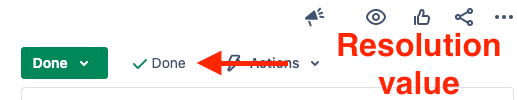

Regarding #1, Resolution would display only when it has a value:

Hm, I guess I don't have the disabled Release button figured out. In my experimentation it seemed that at lease one issue in the Done column had to have a blank Fix Version field or (newly discovered) had to have a Fix Version value for a version that was not yet Released in order for that button to be enabled.
If none of the issues in the Done column had any sort of value in the Fix Versions field, then implementing the subfilter should not have hidden them from the screen. Can you show us the subfilter and Hide Done section of your Board Setting/General screen, and show us one of the issues that ended up hidden but doesn't have a Fix Version value?

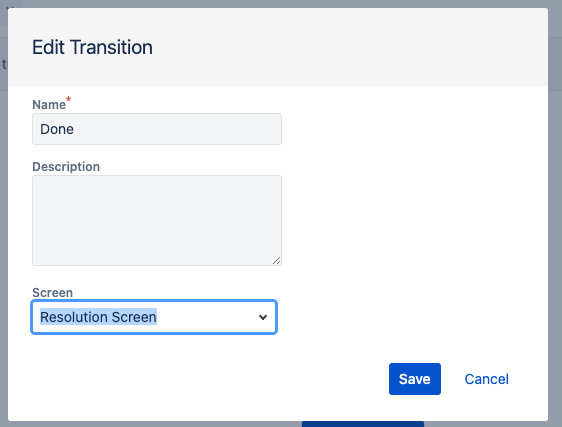

For setting the Resolution field:
If you want to have multiple values available and let the user select one, that is typically done by
1. Create a screen that has just the Resolution field on it.

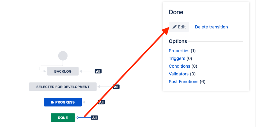

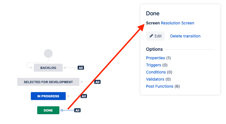

2. Attach that screen to every Transition in your workflow that goes to a green/Done status.
Screen Shot 2023-04-24 at 1.25.22 PM.pngScreen Shot 2023-04-24 at 1.25.49 PM.pngScreen Shot 2023-04-24 at 1.26.02 PM.png
Then the screen will pop open every time an issue (that uses that workflow) is transitioned to "done" and it will make the user select a value for Resolution.

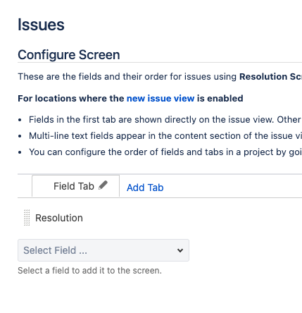

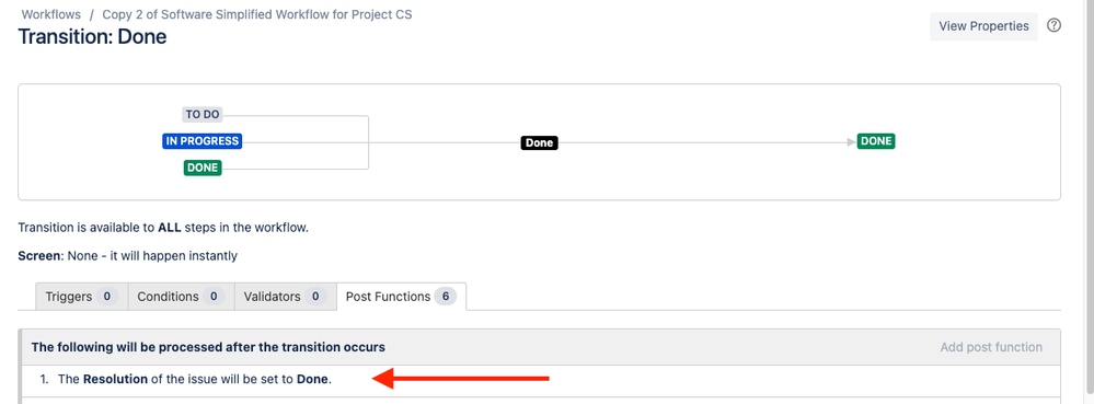

Alternately you have the Resolution field always set to one value (i.e. Done) and you set it automatically with a Post Function on the workflow transitions to green/Done statuses.

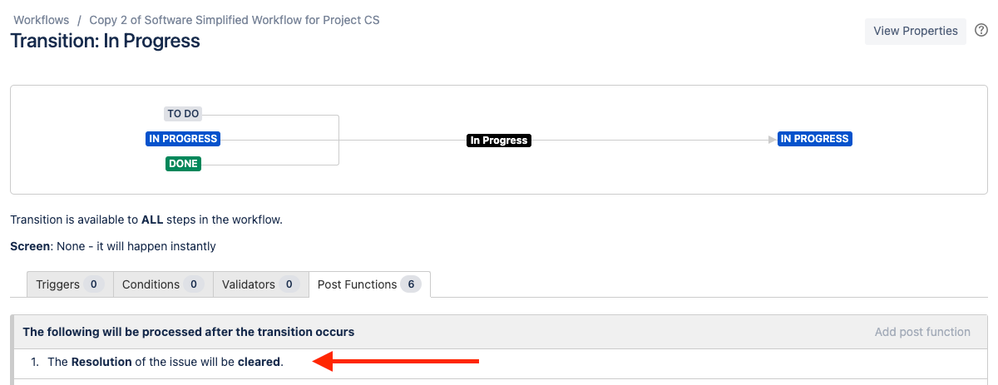

In addition to the above, you should have Post Functions on all the transitions in the workflow to not-green/not-Done statuses to Clear the Resolution field.
YOU MUST NOT ADD THE RESOLUTION FIELD TO THE SCREENS for the Create Issue or Edit Issue operations. When the Resolution field is present on a screen it will always force the user to set a value. You want the value set only when an issue is transitioned to a green/Done status.
Regarding the Fix Version / Kanban board set up, if your teams are educated on using Release Versions, setting the Release Versions to Released, and adding the Release Version to the Fix Version fields in the issues, then using the subfilter is the way to go with your Kanban board.

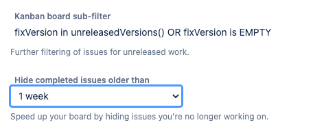

If your teams are not really using the Fix Version field and Release Versions, adding that to the mix would be probably an unnecessary complication.
Instead I would recommend that you use the Hide Done option in the board configuration to reduce the clutter in the Done column by hiding items that have been done for a period of time.
Your options are to hide Done issues that have been done for 1 week, 2 weeks, or 4 weeks.
