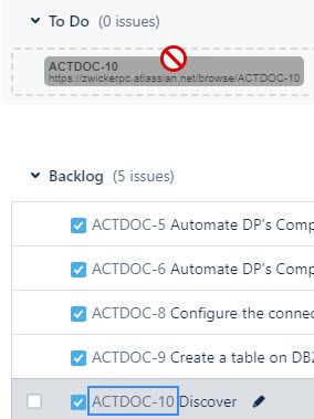

Michael Werner
March 19, 2024
Hello Trudy,
Thank you for your reply. Here is the image.
This was the first time I wanted to move an issue from the backlog to the board for this project since we moved to the cloud.
We are having similar issues on other boards where we can move some issues from one status to the next but can't move other issues.
So I'm afraid your suspicion that there is more going on is correct.
Thanks,
Michael

Michael Werner
March 19, 2024
Hi Trudy,
thank you for all the time you spent looking into this. Yes, I have tried different browsers. I think I figured it out just now.
In this screenshot
When I have the mouse over ACTDOC-5 (the issue ID), click the left mouse button, and drag it to the board, it is not working.
Now, I have the mouse over the issue description, click the left mouse button, and drag it to the board, it works as it should.
I can replicate this behavior with different issues and on different boards (projects).
That doesn't make sense to me.
Thanks,
Michael
