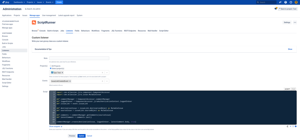

Below is a print screen of the Listener configuration:-

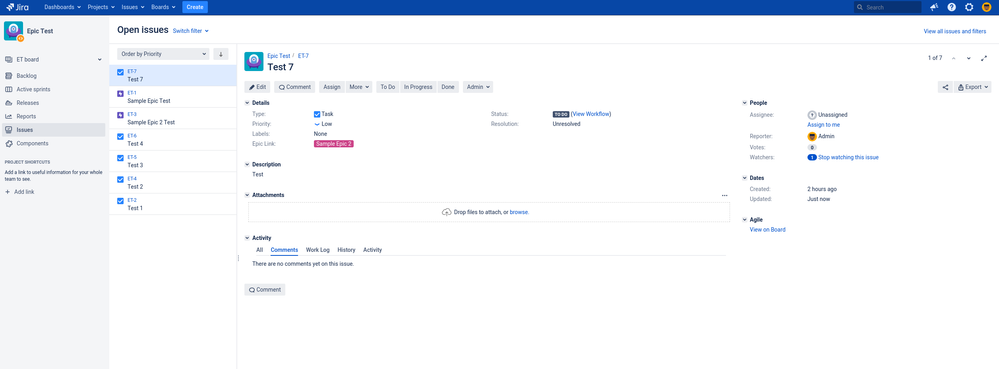

1) The destination issue before it is linked to the source issue:-

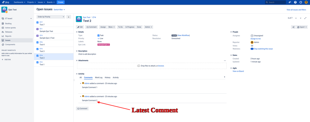

2) The source issue, with the comments:-

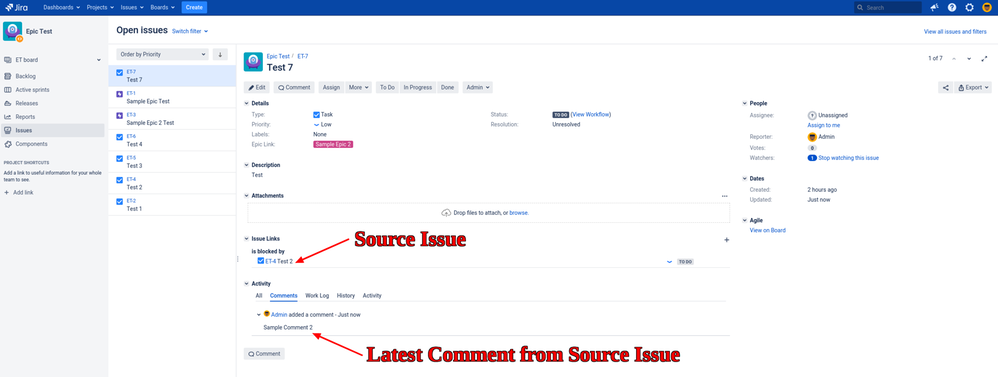

3) The destination issue after it is linked to the source issue with only the latest comment from the source issue:-

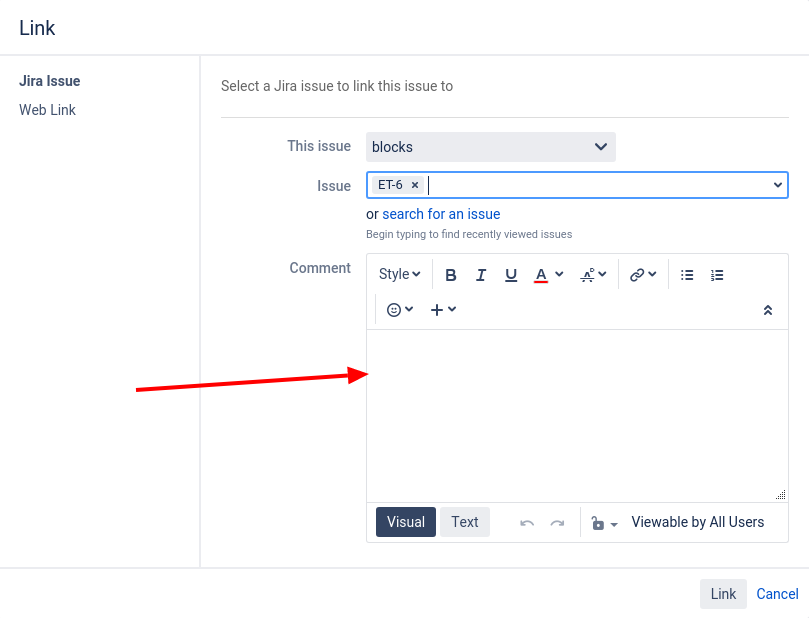

What you are trying to achieve cannot be performed because the comment that is added in the dialog box when creating the outward link, i.e.:-
is not committed to the Database at the time the event is fired.

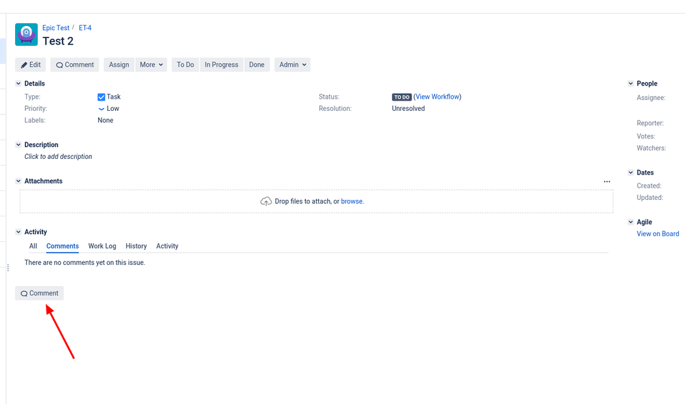

The alternate approach I would suggest is first to add a comment in the comment area, i.e.:-
and then link your issue. By making this approach, you can be sure that the Listener will be able to take the last comment and add it to the linked issue.
