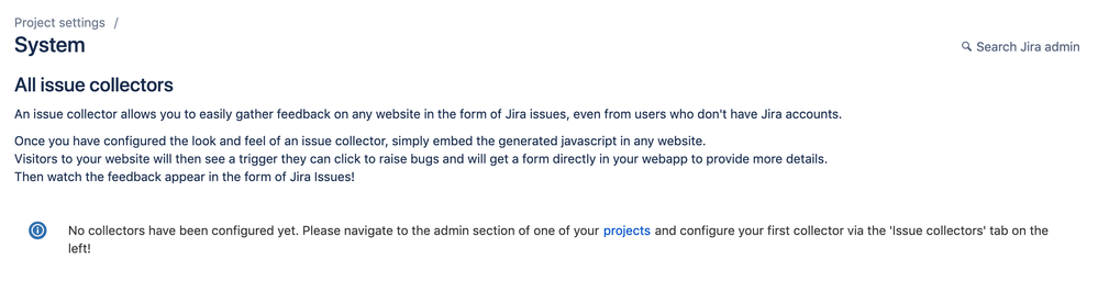

I'm trialing out Jira Software and want to create an Issue Collector. I can find the 'Issue Collector tab in the main settings, but I get this:

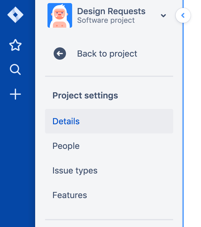

Screen Shot 2019-07-12 at 3.20.02 pm.pngI then go to Projects (I even Googled this and checked all the community answers, following every instruction) but I can't see another Issue Collector tab:

You have a next-gen project and next-gen projects do not have the collector tab. If you want to use issue collectors, you would need a classic project.

Took a minute to figure out. Turns out you gotta create a "company managed" project to use the issue collector with the new interface. I was reading out of date documentation for a while and old solutions from google and got confused for a bit.
So if you have admin privileges, first you gotta make sure your project is of the type "company managed" and NOT "team managed" - and then when you go to your project, choose project settings on the top bar, then look in the sidebar, and find the issue collectors section there.
