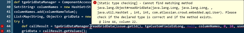

Hi,
I am trying to use a scripted field to extract information from a Table Grid Field, following this tutorial from the editor iDalko:
Using scripted fields to extract information from the grid using the table grid API
Yet I get these errors on line 44 and 45:
Could someone help me please? I don't know anything about script...

Hi,
I think the "error" is only about static type checking you did not type check the grid manager). I think the script will run, even with theses "errors".
Unfortunately the script is not really readable, please provide the full script, I can help you with the static type checking so the "errors" disappear...

Marc Minten (EVS)
January 30, 2019
Hi,
I think your script is correct.
You can ignore these "errors", they are just static type checking warnings , but your script should run correctly...
Did you try it ? Did you get execution errors ?

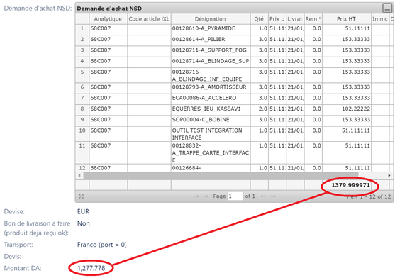

Camille Lecerf
January 30, 2019
Thank you very much Marc for your answer :) I get a result for all my issue now.
Yet I still have a problem here:
2019_01_30_11_39_24_DANSD_1_Ensemble_de_pièces_prototypage_rapide._NB_préciser_à_la_commande_p.pngIs that because it is not the same format? How to set my script field with 12 345,67 and not 12,345.67 please? Or maybe it is because of the number of digits?
Marc Minten (EVS)
January 30, 2019
In your script you load only the first 10 lines of the data grid... :-(
Change the 10 in 1000 or somewhat ?
Camille Lecerf
January 30, 2019
Thank you! This was the problem :)
