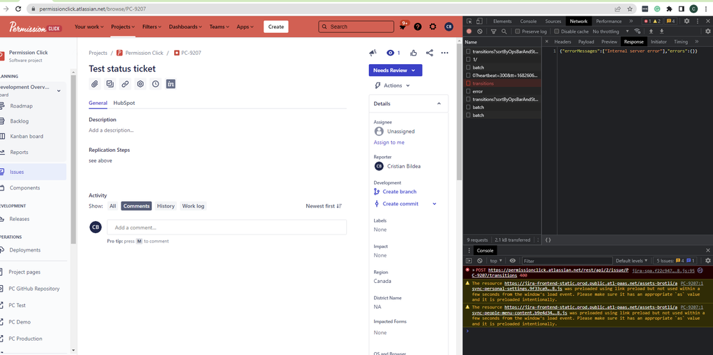

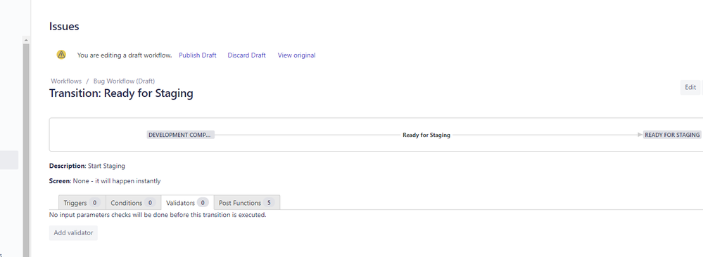

Hi @Esther Strom I dont have setup validators and I have the same issue with Improvement not only with bugs2023-04-27_12h38_25.pngIs not validator 2023-04-27_12h37_22.png
