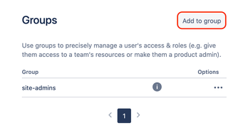

I was able to check that you are a site administrator on the site and you are a member of the group site-admin only.
With that said, I believe that you are facing this issue because you are not part of the groups administrators, jira-administrators and jira-software-users.
Usually, these groups are the ones that give permissions to create and access projects.
Please, go to Screen Shot 2020-04-30 at 10.14.15.png > Administration or Screen Shot 2020-04-30 at 10.08.35.png > User management and add the groups to your profile.
After that, test accessing the project again and let us know if it works.
