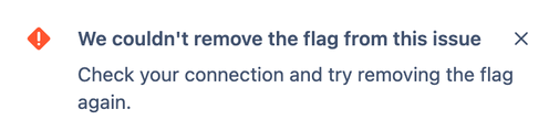

Hi,
Jira - Kanban board - Story
We use Flag to indicate the Issues, which have to be done at first, and that is fore we use a Filter (flagget_impediment).                                                                                            I did not have problems with flagging and unflagging Bugs
BUT
I faced a problem with Flag removing from Story                                                                    I Flagged a Story when it was on the Kanban board in status IN REVIEW (maybe it is important). When the status of the Story was changed to DONE I wanted to remove the flag. I got a system message  "We couldn't remove the flag from this issue.  Check your connection and try removing the flag again"
May I ask for your support, please.
I can not understand the cause of this and what to do to be able to remove the flag.
Thanks

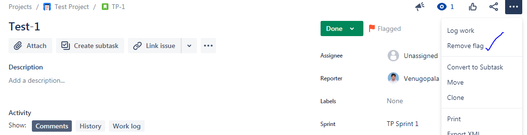

Hi ypilinkevych@elitex.system -
1. Please click/open the issue that you want to flag or unflag
2. In the Issue Detail View, select Add flag or Remove flag from the 'cog' drop-down
3. Please find the attached screenshot for the reference.

I fact I did it many times, but without success. As soon I click on Remove Flag, the flag itself disappears for a second and then appears again together with pop-up
Actually, this fact was the cause to open the request in the community.
