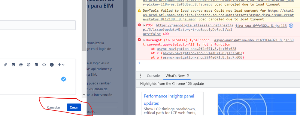

When I try to save a new issue on Jira, the issue is not saved, and I get 400 as answer (see attached picture).
My user has admin right on the projects and I can create and edit issues in any other project.
Just in this project, I can not create new issues, but I can edit and modify existing ones.
