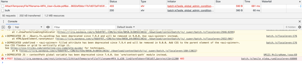

When I ran the developer tools, here's the POST log that I am able to see

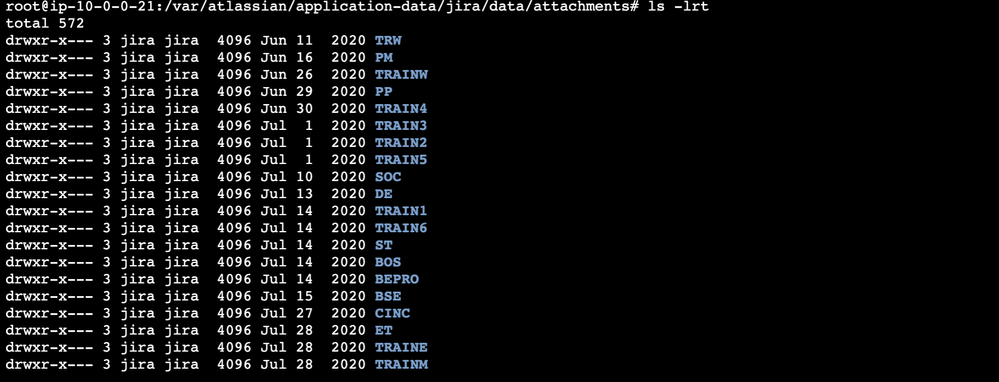

Can you check that:
  1. Your user who starts the Jira service can write to the <JIRA Home>/data/attachments directory? Better yet the whole <JIRA Home> directory.

Danisse
April 25, 2021
Hi @Ismael Jimoh

Ismael Jimoh
April 25, 2021
This is quite odd then.
I am unsure what else could lead to this behaviour.

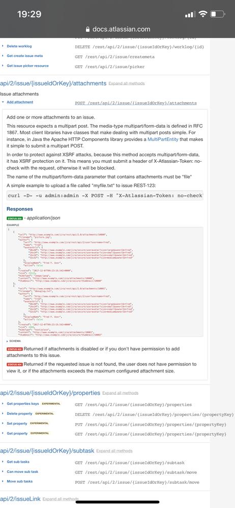

In the end, this is making a rest API call and a 403 means either the user doesn’t have the permission to add an attachment or if adding attachments is disabled.
Could you go to the advance attachments as described here: https://confluence.atlassian.com/adminjiraserver/configuring-file-attachments-938847851.html
Ensure Allow attachments is turned on at least here and if it is also try increasing the limit if it is less than 10MB(the application would normally throw attachment size limit exceptions here but just to rule out this as well).
Also as suggested by @Suhas P @ensure JIRA is running by the JIRA user.
