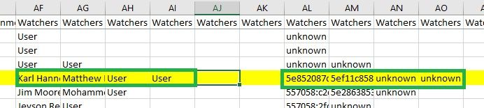

When you create the export, the system will export some, but not all of the data.  I have tried bringing up the data several different ways, including in google sheets (which will only export the total number of watchers and no names).
I am trying to sort out why the system is exporting "User" instead of the 4 users added as watchers.
I looked around at the open issues but did not find one matching this exact situation - there are a bunch which discuss the system not exporting watchers at all, but this does not appear to be what is happening.  In this case, the number of 'watchers' exported correctly matches the number tied to the issue, it is just not exporting all the names/IDs
In the csv file - you can see the 4 watchers listed - but only 2 have names, the rest are "User"

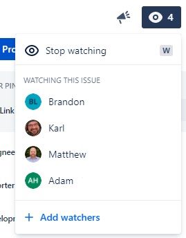

4_watchers.jpgThese are the 4 watchers on the Jira.  All are current, active users.

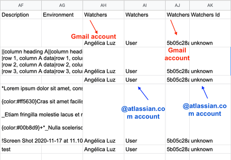

I appreciate that you shared the screenshot. I was able to identify and replicate the same issue on my site.
Checking Brandon's and Adam's email address, I can see that their Atlassian account ID are older and start with numbers, for example, 557058:xxxxxxxx-xxxx-xxxx-xxxx-xxxxxxxxxxxx and Karl's and Matthew's accounts are newer and the IDs are different, example: 1a23b45c6789101d2e345678.
With this said, testing on my local site, I added my main account that has the same ID format starting with 557058:xxxxxxxx and another Gmail account that has the new ID format. The result is that my main account shows as unknown (same as Brandon/Adam) and the Gmail that is new shows correctly (same as Karl/Matthew).
Based on that, I created a bug for our dev team to check:
