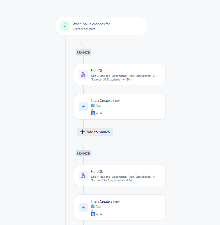

I am trying to create an automation using for each branch using a custom filed from discovery
Deleted user
August 21, 2024
I am trying to create an automation using for each branch using a custom filed. The automation catches that change but doesn't take the action of creating a task as required
when I tried removing the branch it worked but that doesn't serve my need to create a task with different details based on the filed  input

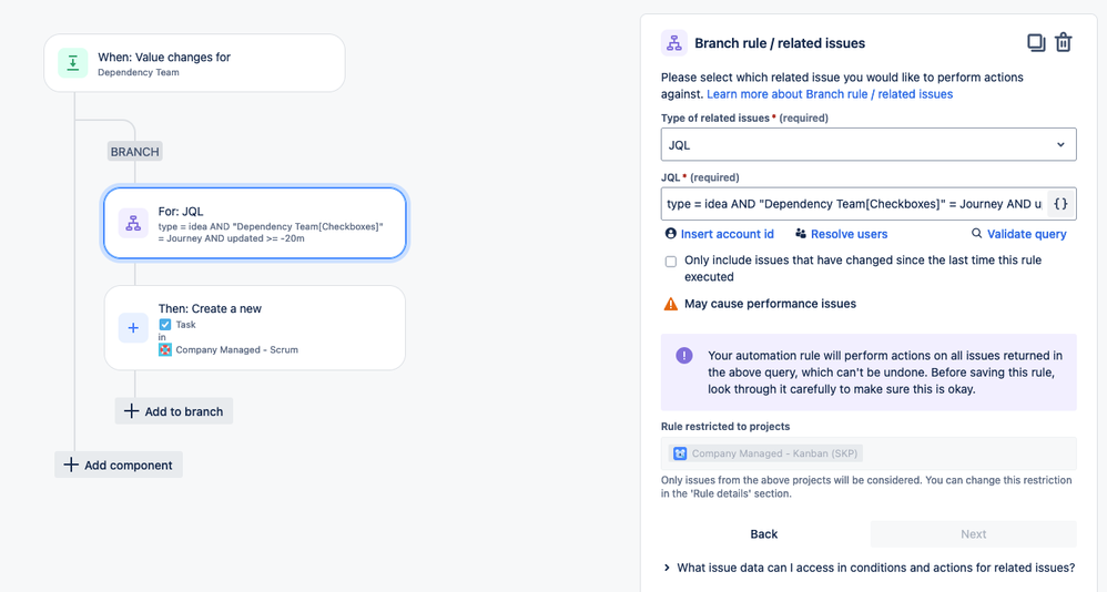

I've replicated the same automation rule as yours, but I haven't included the additional branch. I've recommend to create two separate automation rules for Journey and Partners as well.
Also for the Dependency Team trigger, have you checked for which operations it will trigger. It should be set to any operation,and also for a Change type see if its for any change that has been made.

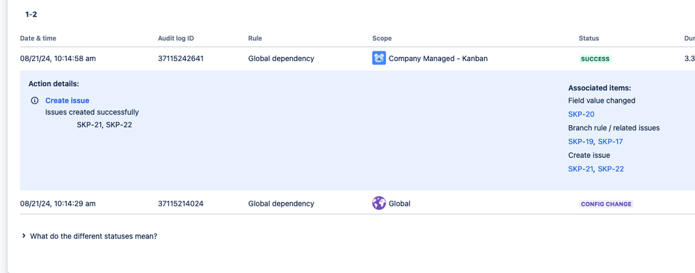

As a final result:Screenshot 2024-08-21 at 10.18.47.png
Additionally, you can use IF/ELSE condition, much simpler than the FOR branch.

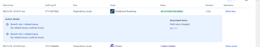

I have the filed update trigger for added value and for edit only can this be an issue ?
I tried using it for all operations but instead it created issues for all discovery ideas that had the filed not empty
I will also include more than 2 cases I was just testing
