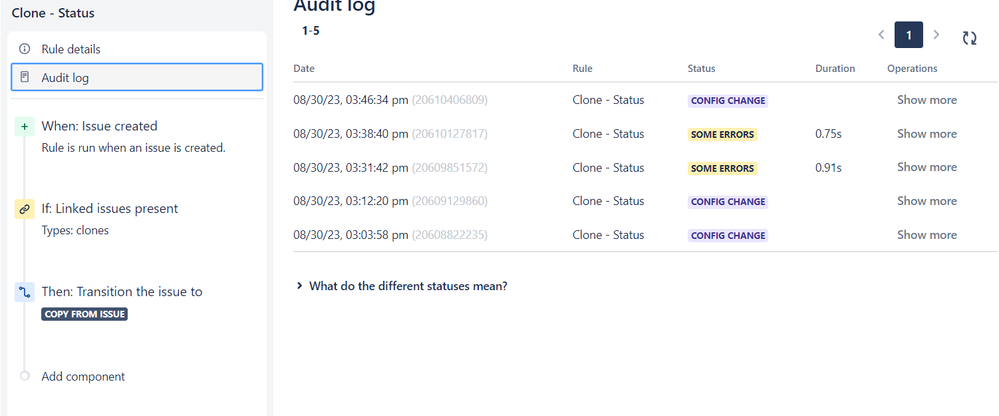

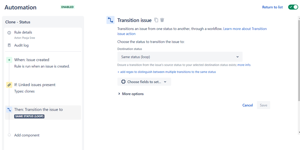

With the help of Atlassian community, i was able to find a way to clone the issues and retain their status. I have added the automation rules perfectly (atleast i think so) but i am getting the below error messages.
Transition Issue:
Destination status could not be resolved. If using a smart-value ensure this resolves to a numeric status ID or untranslated name for issues (with current status):
TT-264 (Unassigned - 10009)

Please show us the details of the Transition step in the rule.
In this case you appear to be trying to transition an issue that is a clone of another issue.
Are you trying to transition that issue to the same status that the original issue is currently in?
Are these issues in the same project? Are these issues the same issue type?
When an issue is cloned it will be set to the initial Status for the workflow for that type of issue in that type of project. If you are trying to set the status of the new issue to match the status of the original issue have you confirmed that you could make that transition manually in the UI to confirm that is a valid transition path?

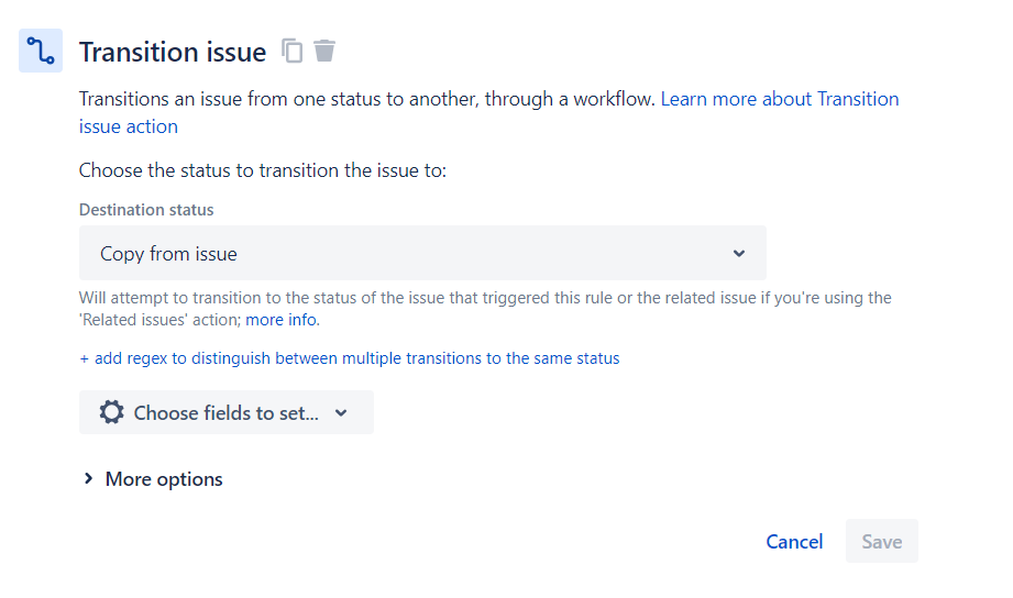

Pooja Sree
August 30, 2023
@Trudy P Claspill Here's the Transition step in the rule.
Yes, Transitioning issue that is a clone of another issue.
Yes, I am trying to transition the issue to the same status that the original issue is currently in.
The issues are in the same project and same issue type. Yes.
No, I have not confirmed if i could make that transition manually in the UI to confirm that is a valid transition path. Please let me know how to do this.

As @Charlie Misonne said, the way your rule is currently written, when you use "copy from issue" in that step "issue" is referencing the trigger issue, so the result is the rule is trying to change the status of the newly created issue to the status it is already in.
What you want is to change the newly created issue (the issue triggering the rule) to the Status of the original issue from which it was cloned.
I have figured out a way to get the information from the original issue, but not yet successfully figured out how to use that to transition the trigger issue.
Charlie's suggestion to branch to linked issues and execute the transition within the branch won't work. When you are within the branch the Transition Issue action will operate against the linked issue, not the trigger issue.

Hi @Trudy P Claspill Thankyou! I have tried Transition issue to "Copy from Issue" and "Same Status (LOOP)" But unfortunately, none of it works.

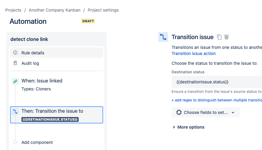

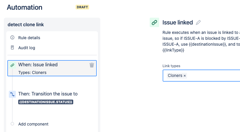

Trudy P Claspill
August 31, 2023
Hello @Pooja Sree
I have found a different rule construct that will get you what you want.
With this rule, if an issue is created by Cloning another issue, then the new issue will be transitioned to the same status as the original issue if that is a valid transition per your workflow.
Screen Shot 2023-08-31 at 11.44.45 AM.pngScreen Shot 2023-08-31 at 11.44.54 AM.png
This rule is triggered by creation of the "cloners" link between two issues. That happens when you manually clone an issue. It would also be triggered if you manually create the clone link between two issues that already exist.
If you are using another rule to Clone the issue, for this new rule you will need to check the box on Rule Details that says "Check to allow other rule actions to trigger this rule. Only enable this if you need this rule to execute in response to another rule."
Note that the transition will work only if the status change from the new issue's current status directly to the status of the original issue is a valid transition in your workflow.

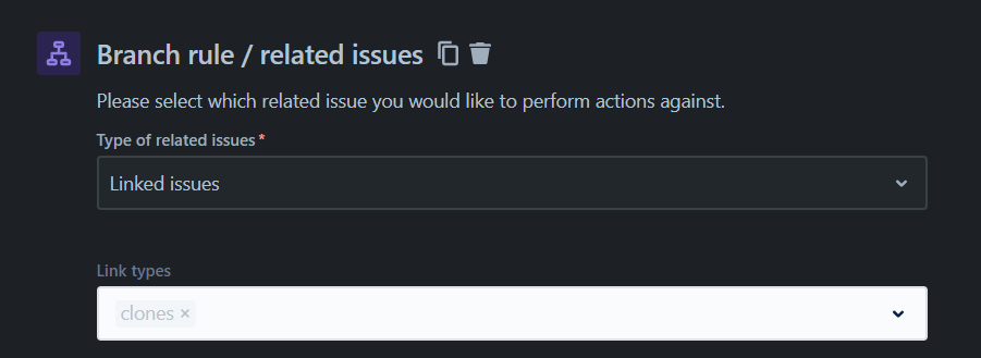

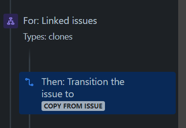

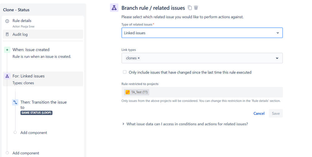

Charlie Misonne
August 30, 2023
Hello!
First question: does you workflow allow status transitions to all statuses?
Secondly: your transition action will not work. You chose "copy from issue" but the "issue" in scope is the actual issue that was created. What you are doing here is copy the status from the current issue and transition it the the same status again.
Instead you should use a for each branch of type Branch rule / related issues like this:
Make sure you use the correct linked type (could also be "is cloned by").
And then you can get the status from the issue like you did:
Pooja Sree
August 30, 2023
@Charlie Misonne Hi Charlie, I cannot allow workflow statuses to transitions to all statuses, as the same workflow is linked to many projects/Issue types.
I have added Branch rule, but still no result.
