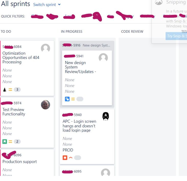

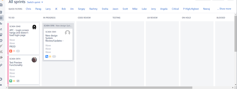

3. This is what I see when set swimlanes to "EPIC"
Are there any issues in your active sprints (issues shown on your board) that are children of Epics?
Swimlanes organized by Epic will display swimlanes only if there are issues on the board that are children of Epics. Issues that are not children of Epics would be shown grouped together at the bottom of the board in a single swimlane. If there are no issues on the board that are children of Epics then then no swimlanes for Epics will be shown.

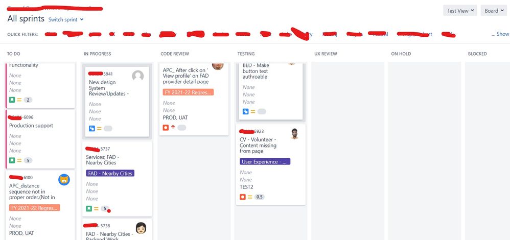

Can you show an example of one of those Epic child stories displayed on the board when you do not have the Swimlanes set to Epics?
These are all stories within the epics when swimlanes is not set to epic

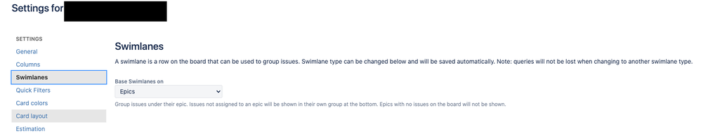

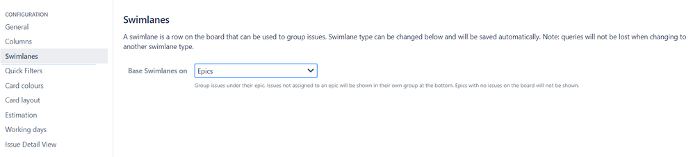

And, just for confirmation, can you show us the Board Settings > Swimlanes screen when you have set it to use Epics?
I see that you have lots of Quick Filters. Can you confirm that you don't have any of them selected, so there is no additional filtering active on the board at the moment?
Here you go. After the board is set to swimlanes->epic.
Yes I confirmed, no quick filters are activated.
Sorry, perhaps I was unclear.
I didn't want to see the board. Instead can you show us the Board Settings > Swimlanes screen when you have set it to use Epics?
Apologies for confusion. Here is the requested screenshot.

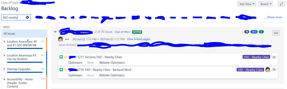

Do the Epics, like "FAD - Nearby Cities", display on the Backlog screen in the Epics pane?
It is not listed under "epics" panel but when I search for it, this is what I get as seen in screenshot.
there are multiple boards in the project and every single issue comes up on multiple boards. Can this be causing any issue. Filters are not configured correctly?any thoughts on that?
If the Epics are not displaying in the Backlog screen in the Epics pane, then they are not being selected by your board filter.
Do you epics have either the Components field set to Optimizers or the Team field set to 000? Your Epics will need to have one of those fields set to match the criteria in your filter in order to be included in the board. All of the issue types you've specified in the filter have to have one of those two fields set in order to be included in the board.

Thank you Trudy for the reply. I can see 3 epics in backlog under Epic pane. Also, all three epics has component set as "Optimizers". Still I am not seeing them filtered on board. Tried the 2 queries posted by you as well.. still not showing results.
