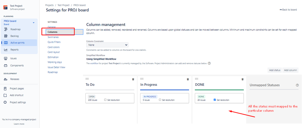

Hi @Amrita Singh  1st reason might be :
 you also need to check with manage sprints , schedule and edit issue permission .
2nd reason :
You must check with your board setting and map all the status with the column then you can close your sprint . There shouldn't be status in the unmpped statuses column  which you are using for the issue completing . I have attached a image below this might help :).
Thanks ,
Rishav
