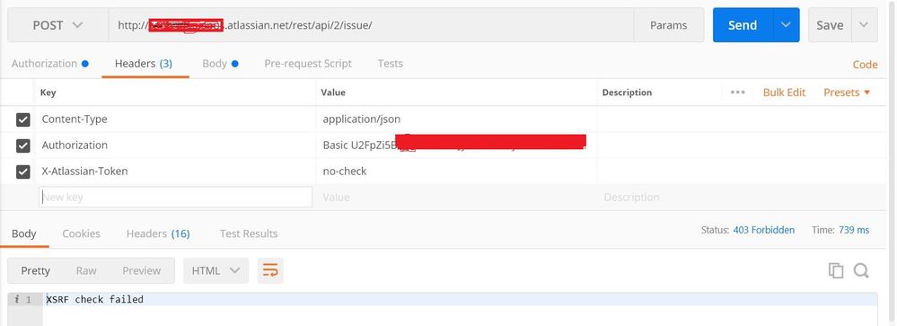

As per the documentation available here : XSRF check failed when calling Cloud APIs | Atlassian Cloud | Atlassian Documentation
I have added the header
X-Atlassian-Token: no-check
but the issue remained same
URL - POST :  http://<mydomain>.atlassian.net/rest/api/2/issue/
Authorization is basic - Username and API key as password
Headers - Content-Type" : "application/json"
Please note : I'm using postman for the testing.
Am I missing something ? I have a site admin and project administrator permissions.

So below is a snapshot of my postman headers :
Thanks for your suggestion , I have changed the JSON as below :

Thanks for sharing the image, can you please replace http with https and then try
Saif Ali
June 9, 2021
Thanks @Muhammad Ramzan_Atlassian Certified Master_ , It worked successfully.
