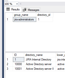

Thank you for the help! I've attached a screenshot of the output from
select group_name, directory_id from cwd_group where group_name='jira-administrators';
with "Select * from cwd_directory" as the last step.
It definitely looks like you are correct, all the "Admin" level groups are within directory_id 1, while my Active Directory servers are showing as directories 10000 and 10001.
What's the best way to correct this while using Active Directory as our main form of authentication?
Also, if we're using Active Directory for authentication will this still allow external customers access to our Customer Channel/Portal?
Please let me know if more information is needed, and thank you for your time!
Andy Heinzer
October 17, 2017
You don't need to worry about customer portal access.  As long as the user has an account in jira, they don't need to be members of any group to access the customer portal site.
But in regards to the loss of Admin rights, there are two different ways to manage this:
  1. Create a group in LDAP/AD that contains these users that should be admins, then sync this group over in Jira, and grant that group administration access.  You can adjust which groups have admin access by following the steps in Managing global permissions.  If you go this route, I'd recommend using different group names such as 'jira-admin-ldap' or something along those lines to keep it clear where this group comes from.
  2. The alternative is to edit the user directory in Jira to use the option "Read only with local groups".  This option would allow you to put these LDAP users in Jira into local groups such as the 'jira-administrators' group that exists in the local user directory.
Either way can work here, it really comes down to a question of where you do want to manage this permission:  In LDAP (Option 1)? or directly in Jira itself (Option 2)?   I think that most enterprise customers prefer option 1 to manage this because when new users come and go in the environment, it's one less thing you have to change in Jira directly.   However some environments that might have really strict LDAP requirements might not be able to change these easily.  In those cases the read only with local groups allow the Jira admins themselves to manage this permission.
