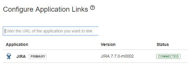

Confirm you are "connected" to JIRA in your Confluence application links.
  • Confirm you now have the JIRA macro.

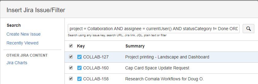

If connected, you should be able to go to a Confluence page, edit the page, and add the JIRA macro.
Edit the macro and insert your favorite JIRA filter JQL:

  • Is the application link "connected"?
  • Can anyone see the JIRA content on the Confluence page?
  • When you highlight Confluence text, do you have the JIRA icon beside the comment icon? If not, definitely sounds like an application link problem.

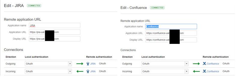

The links on both sides are "connected". The setup is the following:
Our Confluence-Server "confluence-original.xyz.com" is behind a proxy "confluence-proxy.xyz.com" - SSL of course activated.
The Jira-side Link:
Application URL: https://confluence-proxy.xyz.com/wiki
Outgoing/Incoming: OAuth(impersonation)
The Confluence-side Link:
Application URL: https://jira.xyz.com
No proxy
Outgoing/Incoming: OAuth (impersonation)

@Hugo My current setup is:
10.jpgTry connections = OAuth
  • Whenever you change these settings, make sure you are doing this in DEV first.
The only other thing I remember about this setup was having to add a certificate to the trust store.
