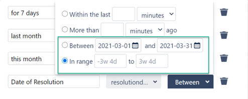

Optionally, when you don't know how to build JQL, you can try to use Dynamic Filters: JQL Replacer for Jira. Choose the date ranges you need (as shown on the screen below), and you'll get the list of issues you are searching for.
